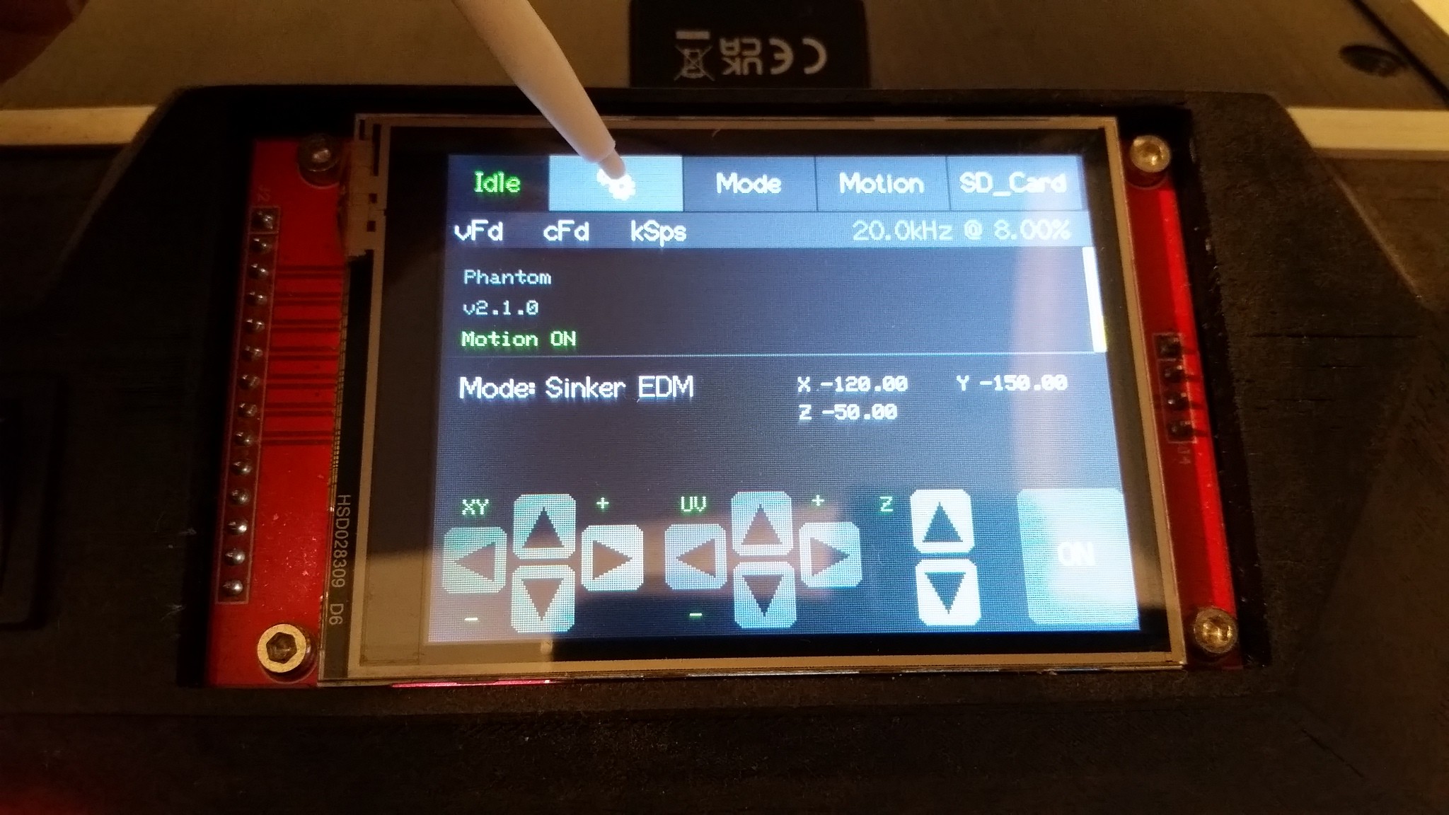

Step-by-Step Guide to Starting a Sinker EDM Job

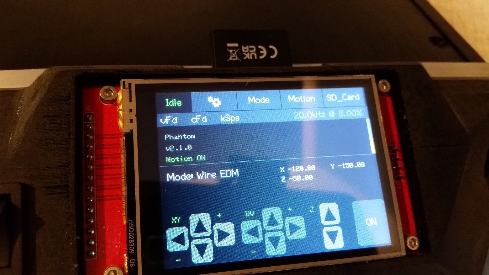

1. Access the User Interface
The front screen of the G-EDM user interface provides all necessary controls and settings. By default, the machine operates in wire EDM mode, so the first step is to switch to sinker mode.

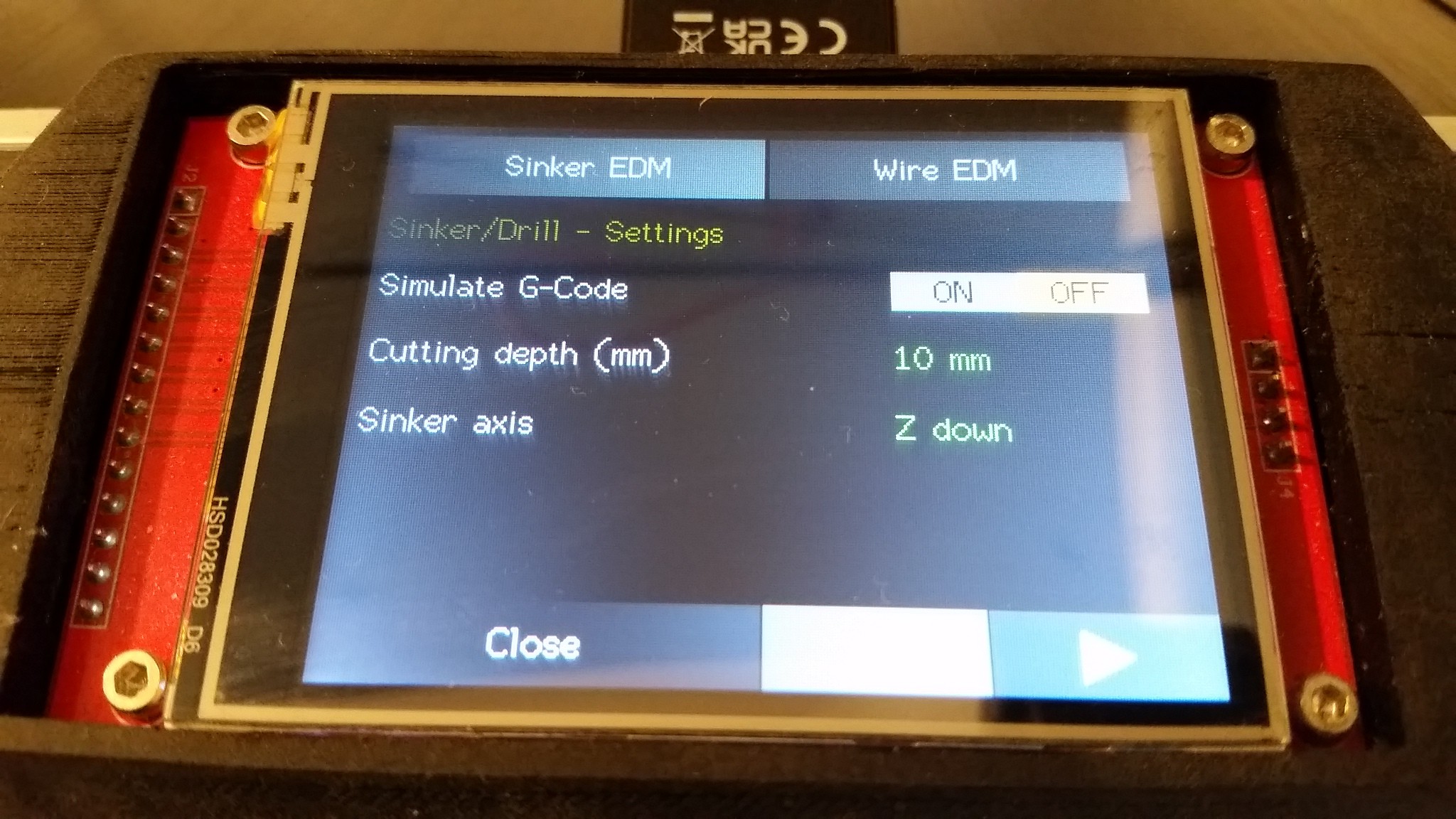

2. Switch to Sinker Mode
Tap the MODE button on the touchscreen to open the mode menu.
Select "Sinker EDM" from the options. The button will highlight, indicating the active mode.
The front screen will update to reflect sinker mode. This selection is stored in the ESP memory and will persist after rebooting.

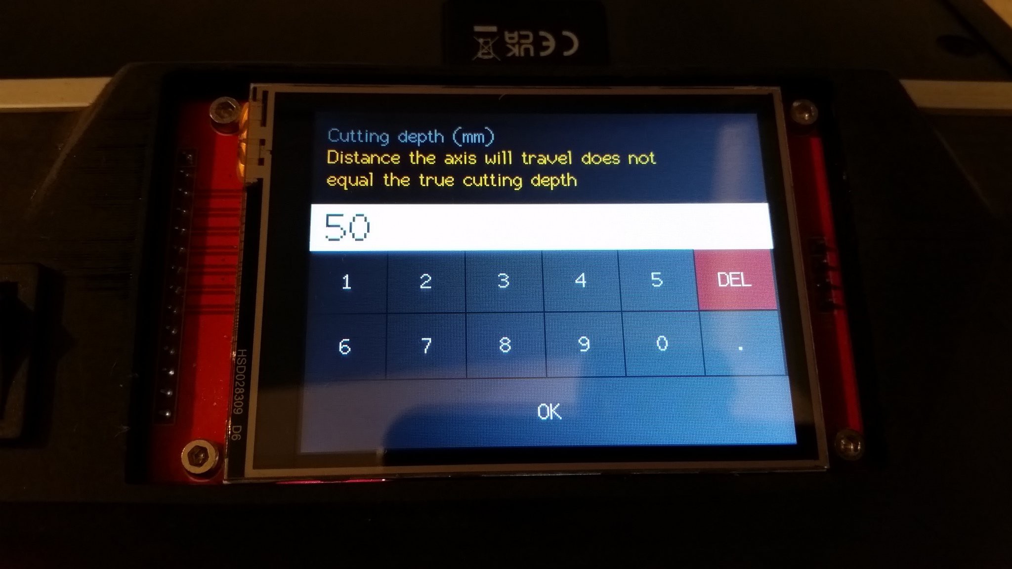

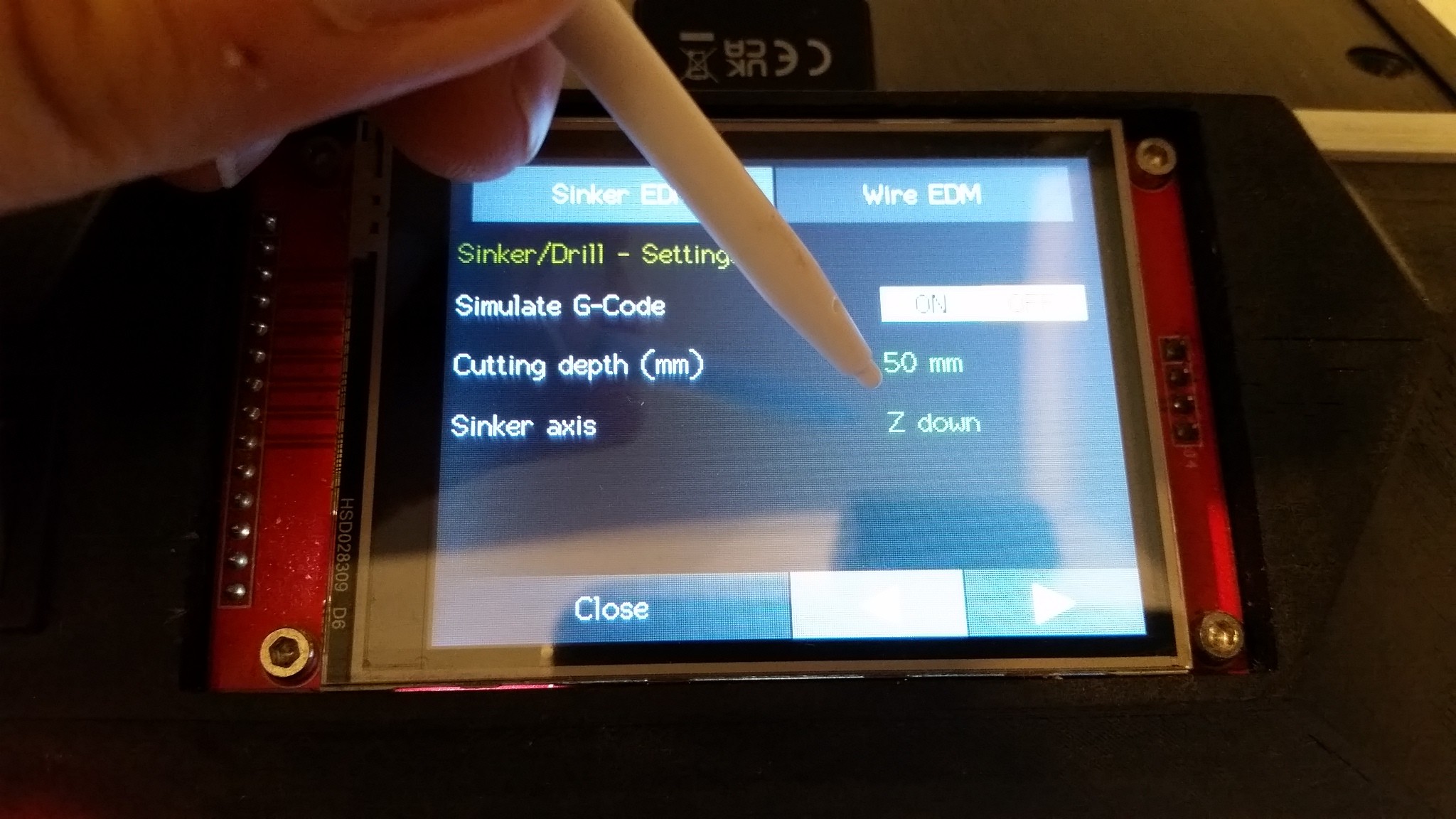

3. Set Basic Parameters
Cutting Depth: The default is 10 mm. Since sinker mode currently does not involve probing for the cutting depth, this value represents the total travel depth after the initial probe.
Adjust if needed: For example, set it to 50 mm for a deeper cut:
4. Confirm Axis Selection
Typically, sinker EDM uses the Z-axis (default). However, other axes like X or Y can also be used.
Note: If you run the XYUV or XYUVZ configuration, selecting X or Y axes for sinker operation will chain axes together (e.g., XU or YV) to run a straight line without tilting the wire.
This is the only setting that is not persistant. It will always be Z down after powering the machine on.
5. Optional: Use the Wire Module for Straight Cuts
If the wire module is installed, you can perform straight-line cuts with the wire in sinker mode.
This feature allows quick, GCode-free straight cuts, which can be very useful.
6. Run the Line
Close the settings menu and head back to the frontscreen. Turn the Motionswitch (On/Off rocker switch) to On to unlock the motion and press the start button on the screen at the right bottom. It will then start. Turning the motion switch off will always stop the process.

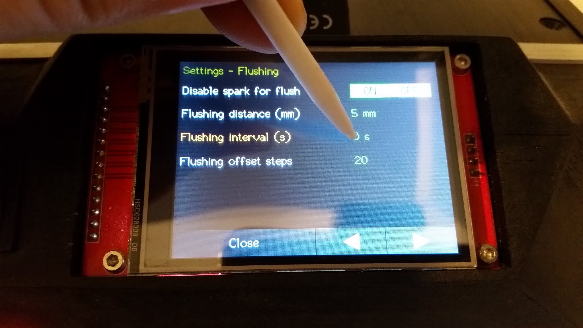

Flushing and Dirt Removal
Sinker EDM creates pockets that can accumulate debris.
To maintain cutting quality, periodic flushing motions are recommended.
You can configure flushing intervals and travel distances in the settings menu under the Flushing section.
After each flushing retraction, the machine returns to the initial position, offset by a configurable number of motor steps (offset steps) to prevent collisions while returning.
Configuring Flushing:
The flushing settings are in the settings menu:

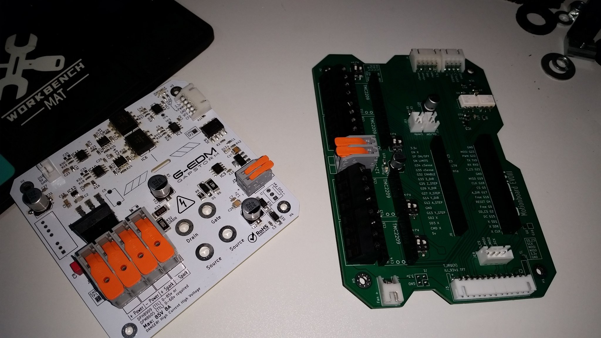

The Gapstorms PCBs are now available on PCBway (project is still in the review process and maybe it takes some days to unlock) Have fun building and cutting.
https://www.pcbway.com/project/shareproject/G_EDM_Gapstorm_Pulseboard_14dd4341.html
PCB footprint reduced to only 99mm x 99mm.
Some through-hole (THT) components replaced with surface-mount (SMD) versions for easier assembly.

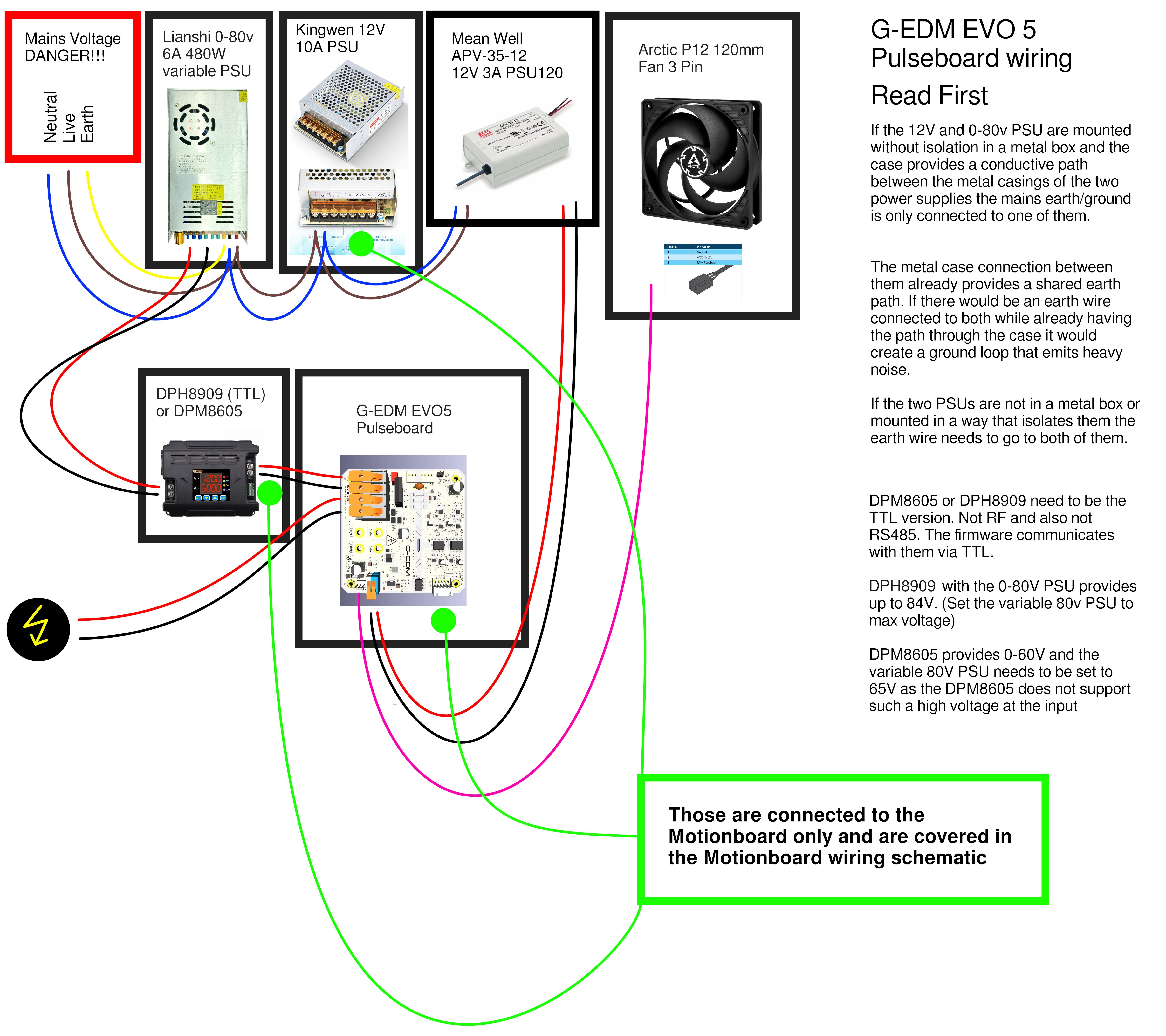

Integrated Current Shunt:
Replaced LM358 with OPA350 for improved performance.
Features two sensing channels: one for current feedback and one for voltage.
Unlike EVOIII, which connected voltage sensing to the power bus and detected only hard shorts via voltage drops, Gapstorm’s voltage sensing provides fast, linear, real gap proximity detection.
Requires firmware update to utilize this feature.
The PCB includes a footprint for converting between gap proximity sensing and bus voltage sensing by unsoldering and repositioning a resistor.
Wiring and Calibration Enhancements:
Power Mosfet Improvements:
Adjustable frequency range up to 100khz is supported by the firmware. In theory the firmware has no problem providing 200khz but it makes no sense and pollutes the CPU too much as there is an interrupt on the rising edge to trigger the readout of the ADC samples. It does skip if there is already a readout triggered but it still is extra load and from what I have seen there is just no need at all for higher frequencies.

Upgrading the EVO boards does not require much experience and can be done by every user with a soldering iron. After those changes they will behave the same as the Gapstorms.

The G-EDM is one of the few DIY wire edm machines that not only comes with the pulse electronics and sensing circuits but also provides it's own firmware.
Making the firmware was and still is the core of the project while the hardware was left as it is for most of the time. It worked very well and there was no reason to look at the hardware much.
Recently I took some time to take a very close look at the sensing circuit and it turned out that the circuit does not fully maximize the potential it has.
I spend countless hours analyzing all aspects of it and test different things.
Many of the tiny discharges where not captured by the current sensing. Based on the information available this is not a big issue and capturing a single static discharge would require very expensive hardware and to run a wire EDM it is not needed as long as the firmware is well programmed.
But that doesn't mean it shouldn't be tried. And while working on the existing unit it turned out that by changing some resistor values and capacitors the sensitivity heavily increased making the current sensing section reacting much faster to even small discharges.
The current channel had three 100pf capacitors in total. One between the shunt inputs, one at the low pass filter and another one on the opamp feedback that controls the linear optocoupler.
I removed the 100pf capacitor on the input and changed the capacitor on the low pass filter stage and also the one on the optocoupler. This improved the reaction by a lot already.
Another thing is the gain of the low pass stage. It was using a zero Ohm gain resistor making it a unity gain opamp. Tiny jumping sparks that are like static discharges create very tiny currents and a very fast. They don't create much feedback but they can indicate reaching the discharge gap distance where sparks start to jump and therefore it would be nice to capture at least some more of them and therefore I changed the gain of the low pass filter. And to make the circuit faster the LM358 was replaced by an OPA2350. The current limiting resistor on the optocoupler was also changed to a lower value.
Those changes can be done to existing boards. There is no change except the component values.
