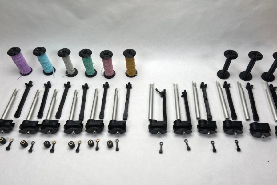

The coil carriers move on a circular path around the braiding point. The distance to the braiding point changes depending on the position of the coil carriers. The ropes must remain taut at each position to get a clean braid. This is done by a tensioning mechanism that works with a spring.
To prevent the rope tension from unthreading the spool, a locking lever is installed that releases the spool piece by piece.

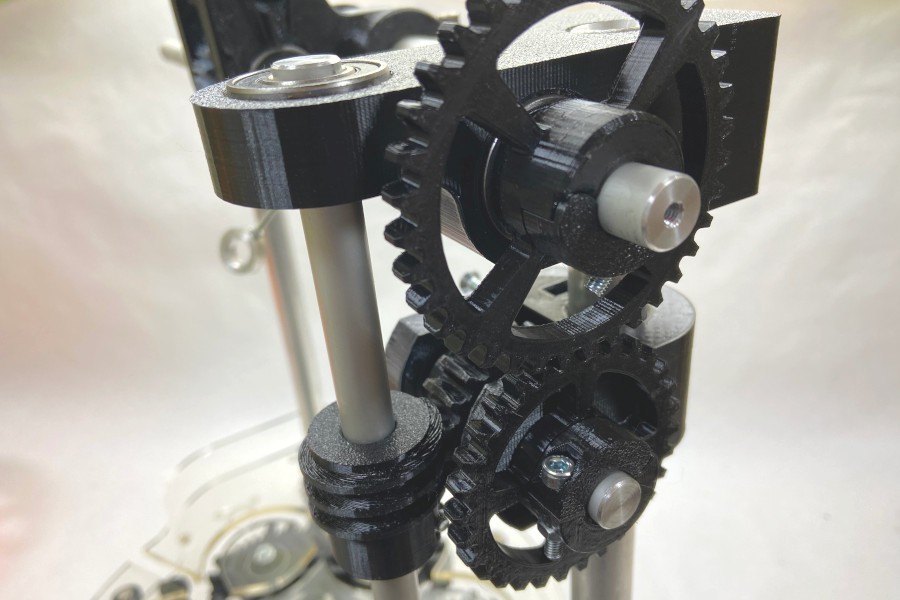

The spool carriers are pushed along in the tracks by so-called horn gears. At the crossing points, the spool carrier changes from one gear to the next. This is a simple but ingenious technique. All gears have involute gearing. This tooth form reduces the friction between the teeth. The base plates are made of acrylic glass.

The machine is built for a maximum of 12 spool carriers. However, fewer can also be used. Build as many spool carriers as you like. It makes sense to have a few more spools for a quick exchange on the machine.

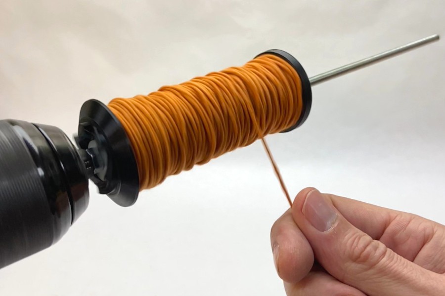

I use a cordless drill to wind the coils. For clamping the coil, there are cone pieces that are pushed onto a threaded rod. The correct winding technique is essential to have a good running machine. The line must always cross over on the spool so that it gets stuck. The cords should not slip into each other. This is done with a back and forth movement.

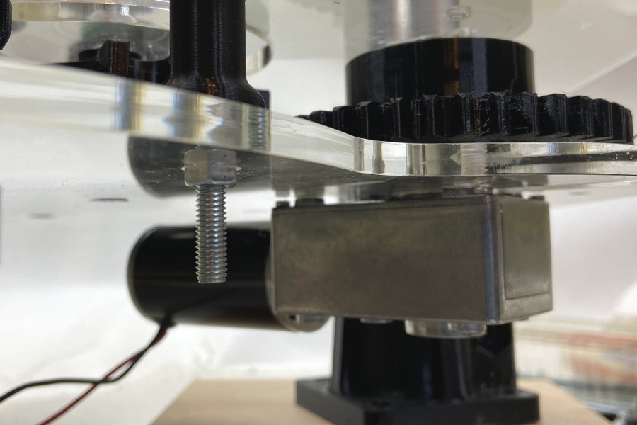

The machine is driven by 24V geared motor. Some drive power is needed to move the coils. The power needed to pull the braided rope is not to be underestimated. In addition you have high friction forces on the spool carriers that have to be overcome. You can choose to run the machine with one or two motors. If you use 6 or less spool carriers, you can install one motor. If you use the machine with 12 spool carriers, 2 motors are needed. To control the speed of the motors, a simple PWM controller is needed. Both motors can thus be operated in synchronism.

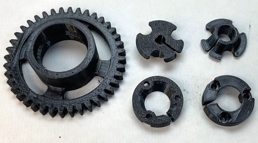

The connection of the motor and the drive gear is solved by a 3D-printed clamping set. The clamping set has the task of connecting the drive gear with the motor and the shaft to the worm gear. Developing a 3D printed clamping set took me a lot of time. The difficulty is to center the gear on the motor shaft without it wobbling.

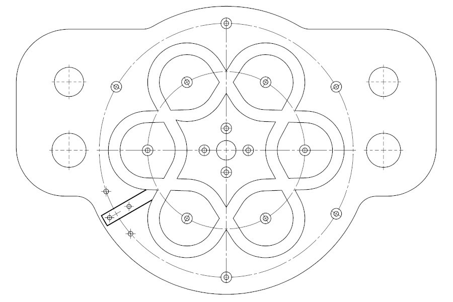

  • Acrylic base plate with the tracks:
My acrylic plate is laser cut. You can cut it out with a lot of patience and a steady hand with a decubier saw. You can also mill the base plate.
Here you can see the overview drawing of the machine:
