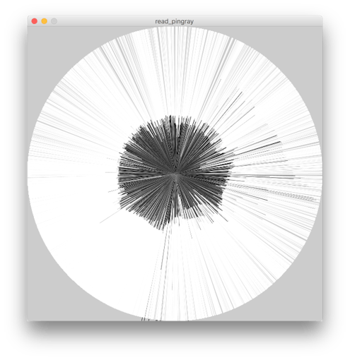

Please see the below code section to find the code. It simply takes readings from the compass and 4 sensors one after the other and prints them to serial. One line for each batch of readings. Also, there is a Processing sketch to visualise all this data sent.
For each heading value in degrees, I drew a line with the length of the distance read by the sensors. This visualisation was expected to be a square - as my room is a small 3x3m square, while the range of these sensors is upto 4m.
Unfortunately, it appears circular instead of a square - which is the shape of my room. You can notice a wall showing up as a flat line on the right side. But other than that the values seem to be all over the place.
Here is another one in which I tried standing at the corner of the room and then rotating while standing in one place. Here, the corner is much better visible. But why isn't this working as expected?

But after further discussion with him - he made a very nice point - that the echo's from the walls will make it seem that everything is as close as the nearest wall!
You see, the beam sent from the sensor gets quite wide as the distance increases, so even if the sensor is trying to read the distance to the corner of the wall, it is actually receiving the fastest echo from the wall closest to it!
Hence in our plot above - we don't actually see the corners of the room. This is the reason why it simply appears like a circle. Thanks to Kirti, I finally understood it!

"... reading all over the places ..."
I had little success getting consistent results from these sensors. My results are similar to yours.
Other issues include:
Depending on the source of your HC-SR04, the timeout can be more than the documented 38ms. My units were around 200ms. This is a problem because these sensor can miss a pulse every now and then. Retrigging the sensor before the timeout returns a zero or near zero reading.
I don't know why but the sensors can suffer "dead spots" or more precisely "dead directions". Probably due to nulls in the interference patterns. In theory a multi-sensor array would bet around this but I had no great improvement.
Another issue (not related to this sensor) is that a wall at more than 15 degrees off perpendicular may not return a response.
