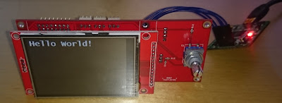

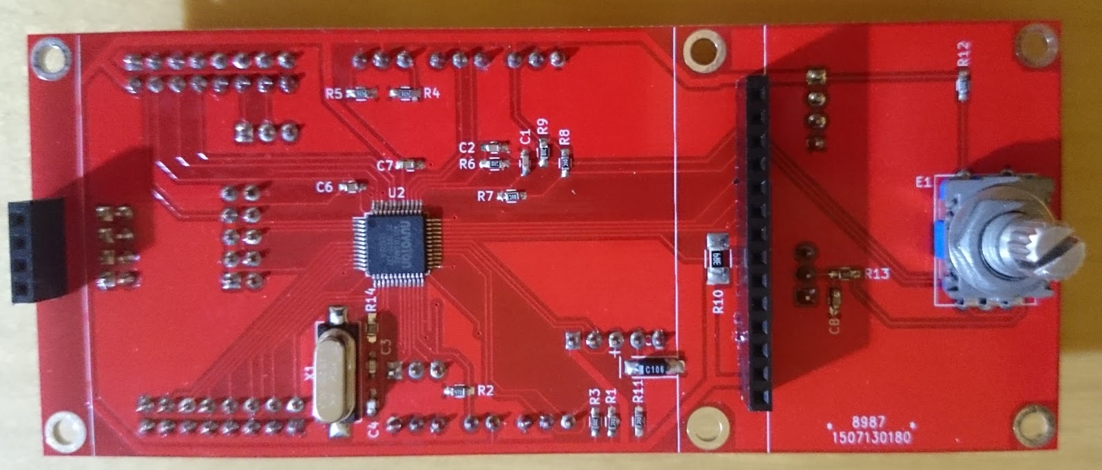

  • Front Panel Board Build
    SUF08/13/2015 at 13:39 0 comments

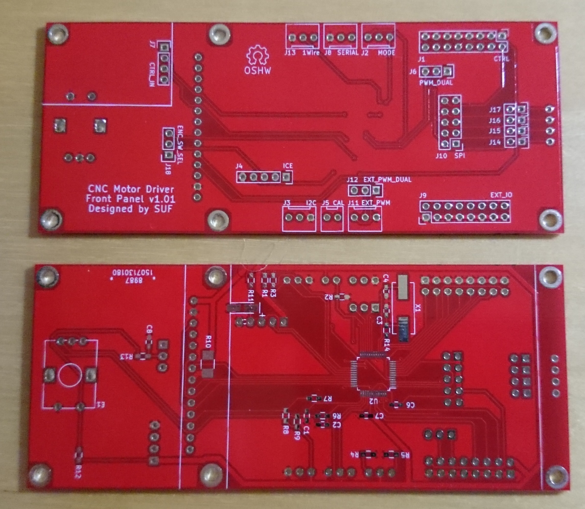

    More than a week ago the boards finally arrived:
    Then I soldered the parts into it:
    I picked one of my Nuvoton development board, cut it to it's parts, and soldered the missing headers, to be able to use it as an ICE programmer/debugger:
    Finally, I started to rewrite the controller's program, to the new pin configuration. During this process, I also want to little bit clean up the code.
    To test the board is working, I wrote a "Hello World" for it. :-)
    The board looks like working so far. The next step would be to finish the conversion/clean up the code.

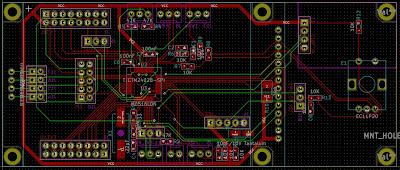

  • Front panel design finished
    SUF07/20/2015 at 04:01 0 comments
    As I promised my previous post, I made some tweaks on the front panel schematics. To be precise, connected the push button of the rotary encoder to the MCU. This gives me the flexibility to use the rotary encoder to navigate in some kind of menu system (if I write some code for it), able to eliminate the additional physical controls (mode switch, calibration switch), and provide the possibility to add more function. Here is the modification of the schematic drawing (actually I can't insert the full page here - lack of resolution of the computer where I'm writing this actually. All of the drawings can be downloaded from the github repo)
    I think, the current schematic will be the final one, if I don't find any additional problems with it. So I designed the board:
    And ordered it form the dirtypcbs.com
    Waiting to arrive...

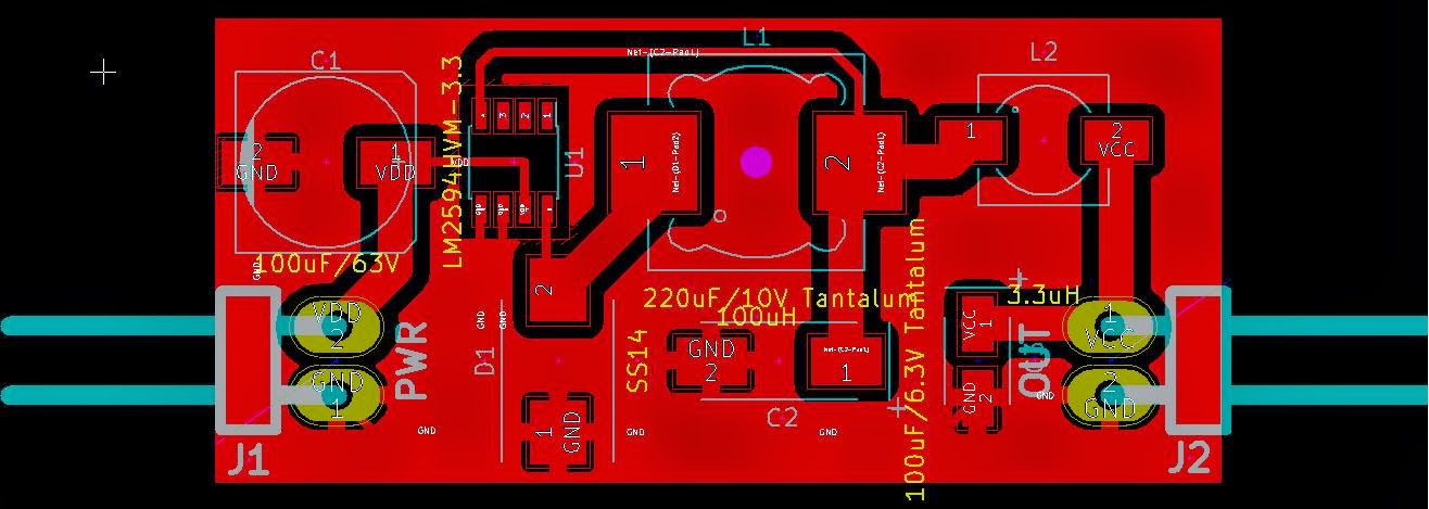

    In the mean time I designed the test circuit/board for the power supply of the low voltage parts of the circuit. The MCU, the measuring amplifiers, the display will run from 3.3V (I planed to use 5V supply originally, but the display I'm using is not able to run from it). This supply finally not as cheap I wanted to have. It was clear that I need a switching mode supply, and a chip with high voltage capability. I know that a few hundred milliamps is not to much, and the whole circuit is powered from the mains and not batteries. This is a good candidate for some three leg standard regulator or LDO, but...
    Always, that but.
    the whole circuit will run from a single 48V supply. Generating just 100mA with a standard regulator means you have to dissipate 4.47W on the regulator. In addition the standard three leg regulators are not designed for 48V input voltage.
    So the decision is to use HV buck regulator. Especially the LM2594HV-3.3 model from TI.
    I designed a circuit around it:
    And a PCB for testing:
    The finished board (population come later):

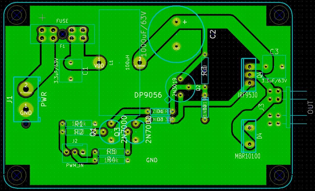

  • V2 Boards
    SUF05/05/2015 at 09:05 0 comments
    I planed to build the new motor driver during the weekend, what unfortunately doesn't happened. It took an additional week. What I want to mention here, that together with the motor driver I also designed a new measurement circuit. This one is able to measure not just the rotational speed but the current (it was also in the previous but untested) and the voltage of the motor. In addition I included the necessary protection diodes what was left out from the previous one, and a configurable fifth order low pass filter to test the filter for the final design.
    Here is the schematic diagram:
    And the PCB design:
    The first weekend achievement - etching the boards and collecting the parts:
    A week later - the boards cut, populated:

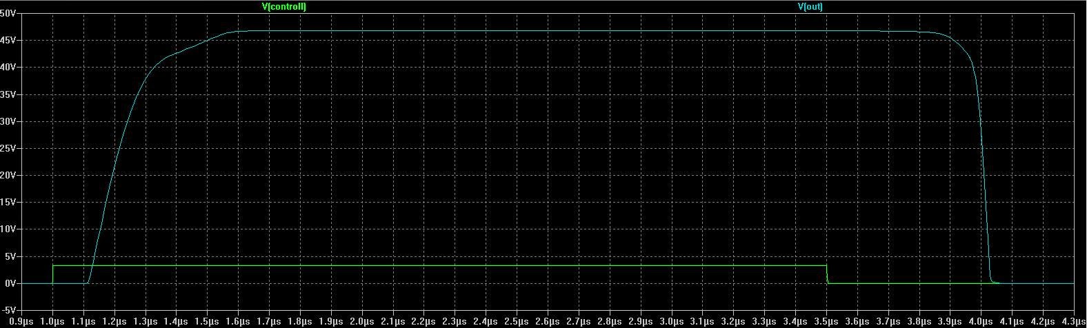

  • MOSFET driver revised
    SUF04/25/2015 at 21:36 2 comments

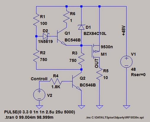

    I was thinking, looking around a lot before I designed and built the current motor driver circuit. I wanted to use something cheep, something I can learn from.
    The current one is working, but I was thinking, how can I make it a little bit faster. When I designed the current one, experimented lot on the breadboard, but not used ltspice to simulate the circuit. When it was finished, I needed to tweak it, here and there, to be able to reduce the noise for the clear measurement signal.
    Now I'm trying to get faster switching, to reduce the heat generated by the MOSFET.
    First of all I run a simulation of the original circuit.
    The circuit:
    And the result:
    As you can see the the timing results:
    Switch on time: ~500ns
    Switch off time: ~500ns

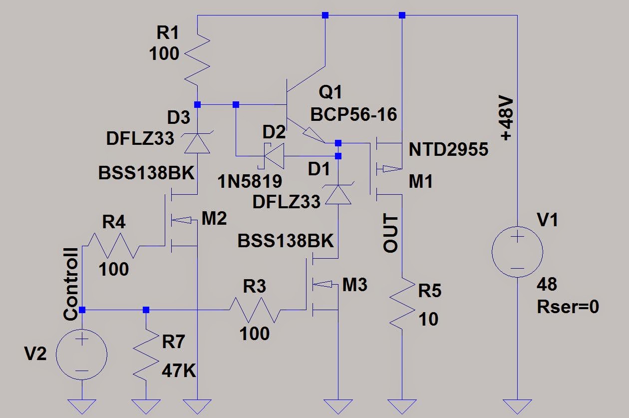

    After 2-3 weeks of continuous (in my spare time, what I not really have to much) simulation, changing components, pursuing different ideas, finally I created a little bit better one.
    The circuit:
    And the result:
    And the timing:
    Switch on time: ~30ns
    Switch off time: ~100ns
    Much better.
    Based on the things above, I designed a little bit different circuit. The reason: I use mostly trough hole components for the home made PCB and switch to SMD when I order the final one.
    The schematic
    And the PCB design:
    Hopefully I'll be to build it during the weekend.

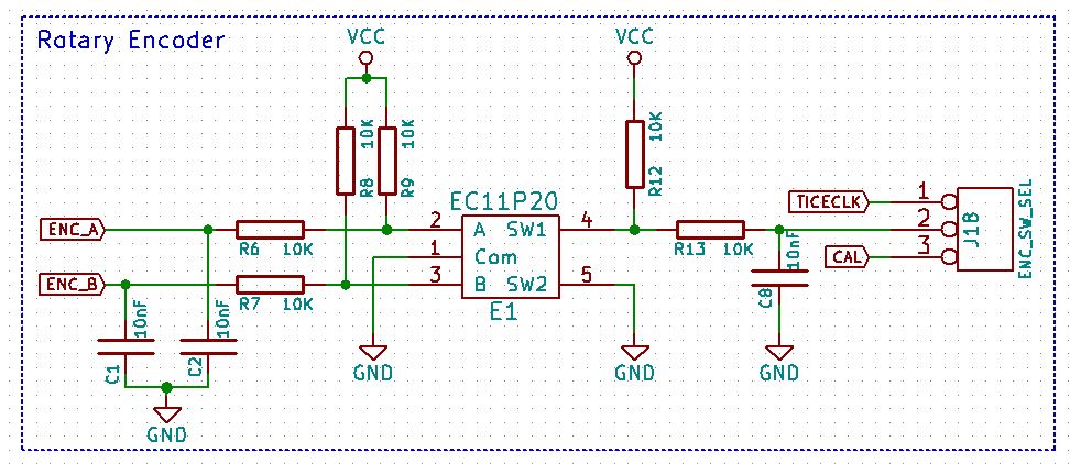

  • The MCU control works!
    SUF04/06/2015 at 22:05 0 comments
    Since the last post regarding my CNC Motor Driver, in my spare time I was continuously working on the MCU board and the software for it.
    Two days ago I connected the digital part to the power electronics. It started to work immediately, but unfortunately the rpm measurement was messy.
    After some thinking and trying, I realized, that the source square wave has some narrow pulses around the edges, what are messing up my measurement.
    The Nuvoton MCU I'm using is able to add some de-bouncing delay to the timer's capture input. Adding this feature looks like solving my problems.

About the MOSFET control. I'm not an expert in this field either. In the beginning, I just wanted to create an easy N-Channel low side driver. As I was digging deeply into the measurement problem, I realized, that I need to build something looks much more like a Buck mode SMPS  than a MOSFET switch.
You right that you can cheaply buy an integrated high side MOSFET driver for almost nothing. This drivers are able to drive an N-Channel MOSFET on the high side with bootstrap capacitor. And yes the N-Channel MOSFETs having better electrical parameters than the P-Channel in use here.
To go further, you can even buy half bridge controllers for nuts instead on the high side driver achieving better results with synchronous buck mode. Even I was trying to use ST's L6384E, in this circuit. But...
Always a but... somewhere. :-)
The required load of max 10A can be easily handled with relatively good P-Channel MOSFET (it has less than 1nF gate capacitance, the low gate capacitance is a key element here).
The L6384E (basically the only half-bridge controller can be purchased here for reasonable price - didn't wanted to take into consideration the free engineering samples keeping the whole design easily rebuild able to anybody wish  to), was not able to go far beyond the 20kHz mark, because of the required dead-zone setting.
