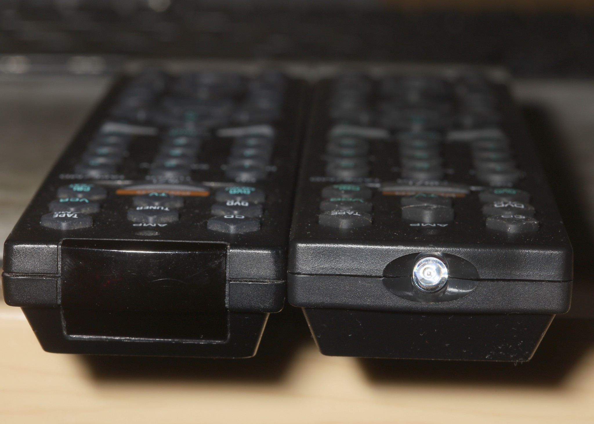

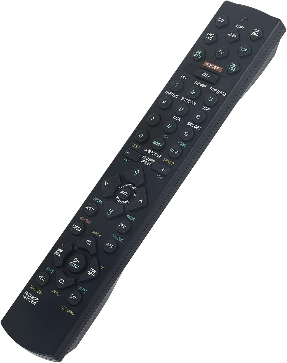

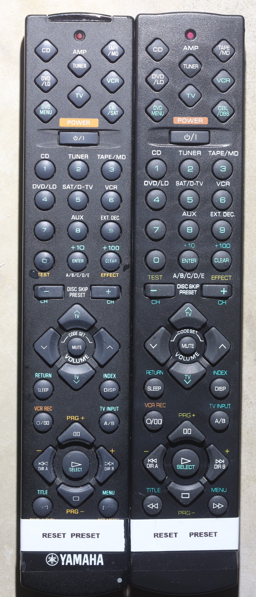

    The vintage 24 year old RAV205 eventually perished as its carbon contacts wore out.  After years of pondering a replacement, no modern learning remote could compare.  There are actually clones of many vintage remote controls.  For this application, they're actually more ergonomic than any learning remote.   Amazingly, clones of the RAV205 are still made but the clone no longer worked with the clock.
    Ported over the updated IR code from the F-35 nozzle https://hackaday.io/project/187856-f-35-air-vent & improved it slightly.  The mane trick is it dumps every IR bit it receives into a buffer.  It resets the buffer when the contents match a known code or if it doesn't receive a bit after a timeout.  It checks all the known codes when it hits 2 offsets, since the RAV205 generates codes of 2 different lengths.  The old algorithm used a rotating buffer to handle remotes which transmitted the same code over & over.  In reality, they don't transmit the same code over & over.  They just transmit the code once & then send repeating 1 bits until  the button is released.

  • New remote arrangement
    lion mclionhead • 09/19/2020 at 23:34 • 0 comments
    With the addition of seconds & the remote also supporting the robotic air vent, it was time for some adjustments.
