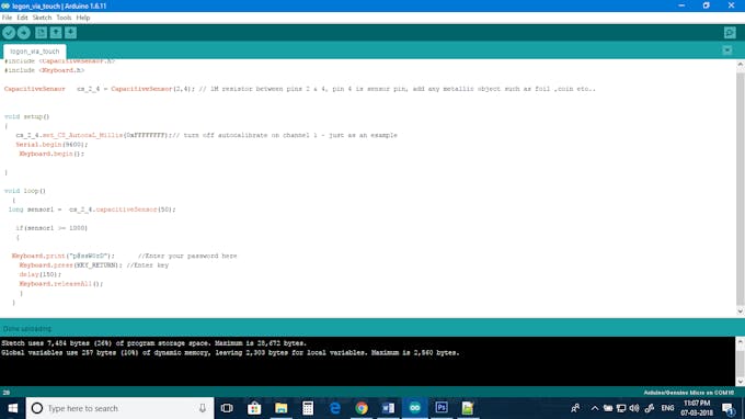

Arduino Code:
#include <CapacitiveSensor.h>
#include <Keyboard.h>
CapacitiveSensor cs_2_4 = CapacitiveSensor(2,4); // 1M resistor between pins 2 & 4, pin 4 is sensor pin, add any metallic object such as foil ,coin etc..
void setup()
cs_2_4.set_CS_AutocaL_Millis(0xFFFFFFFF);// turn off autocalibrate on channel 1 - just as an example
Serial.begin(9600);
Keyboard.begin();
void loop()
long sensor1 = cs_2_4.capacitiveSensor(50);
if(sensor1 >= 1000)
// the below code can be used to simplify your login
Keyboard.print("p@ssW0rD"); //Enter your password here
Keyboard.press(KEY_RETURN); //Enter key
delay(150);
Keyboard.releaseAll();

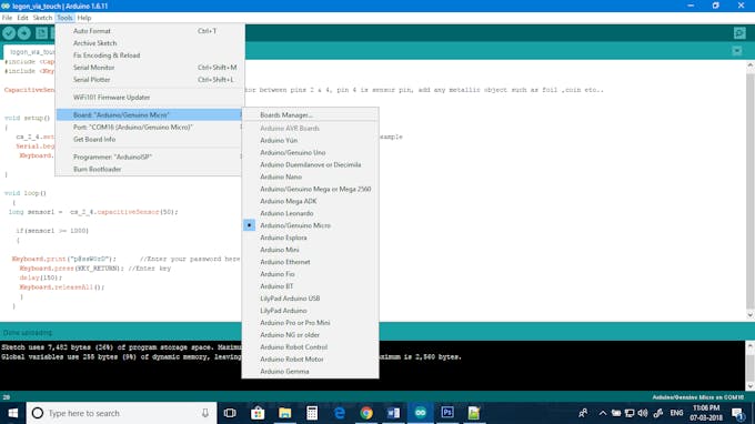

- Launch Arduino IDE
- Select board
![](https://hackster.imgix.net/uploads/attachments/445732/image_Zd7780a4cR.png?auto=compress%2Cformat&w=680&h=510&fit=max)

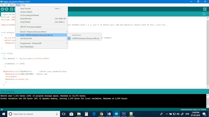

- Select port
![](https://hackster.imgix.net/uploads/attachments/445731/image_MFp4A1M0wM.png?auto=compress%2Cformat&w=680&h=510&fit=max)
- Upload your code
![](https://hackster.imgix.net/uploads/attachments/445733/image_hwuZePMsBR.png?auto=compress%2Cformat&w=680&h=510&fit=max)
