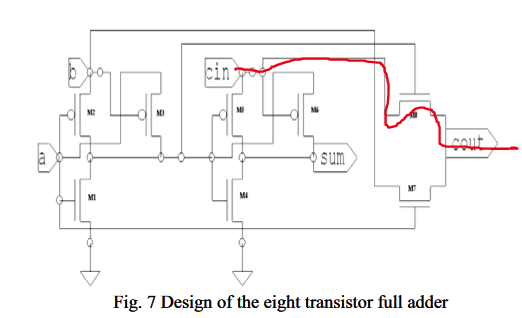

Another source https://waset.org/publications/1588/a-high-speed-8-transistor-full-adder-design-using-novel-3-transistor-xor-gates explains in great detail why the short circuit is not such a big deal for ICs : they tune the width/ratio of certain transistors to minimize the unwanted current. This trades space for power consumption.
M1 has a 1/1 ratio, almost a square, wih minimal size, hence highest resistance, while M3 has a high ratio to overcome the pull-down from M1. For very high-speed CMOS circuits, where power is dominated by switching (and leakage for the newest processes) this short current can be considered "negligible".

The analysis in the linked paper is nice.
Edit:
That paper is actually cheating a bit with the transistor count: https://cdn.hackaday.io/images/8079621600927911414.ef9c7d73b06c9f38cae6b3bf15a8a5df. There is a weak path where a ripple carry would lead to incremental device stacking.
It also seems they only simulated the isolated circuit...
I wish Falstad's circuitjs let us simulate these sorts of transistors :-)
