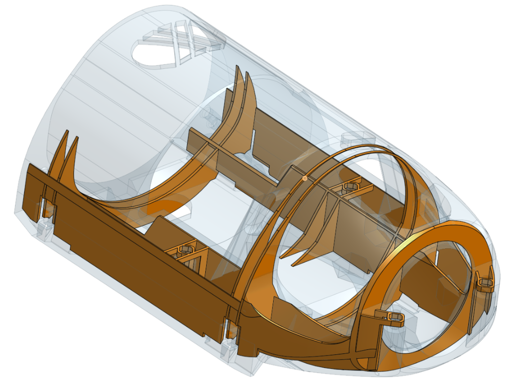

Meh. New Z is fail.
05/03/2024 at 22:26 • 0 commentsPretty but not stiff. Time to learn me some FEA? Back to the drawing board.

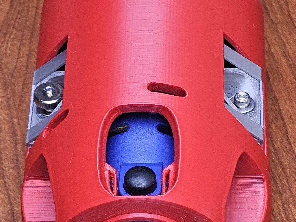

Thumb nuts > bunch of screws.
