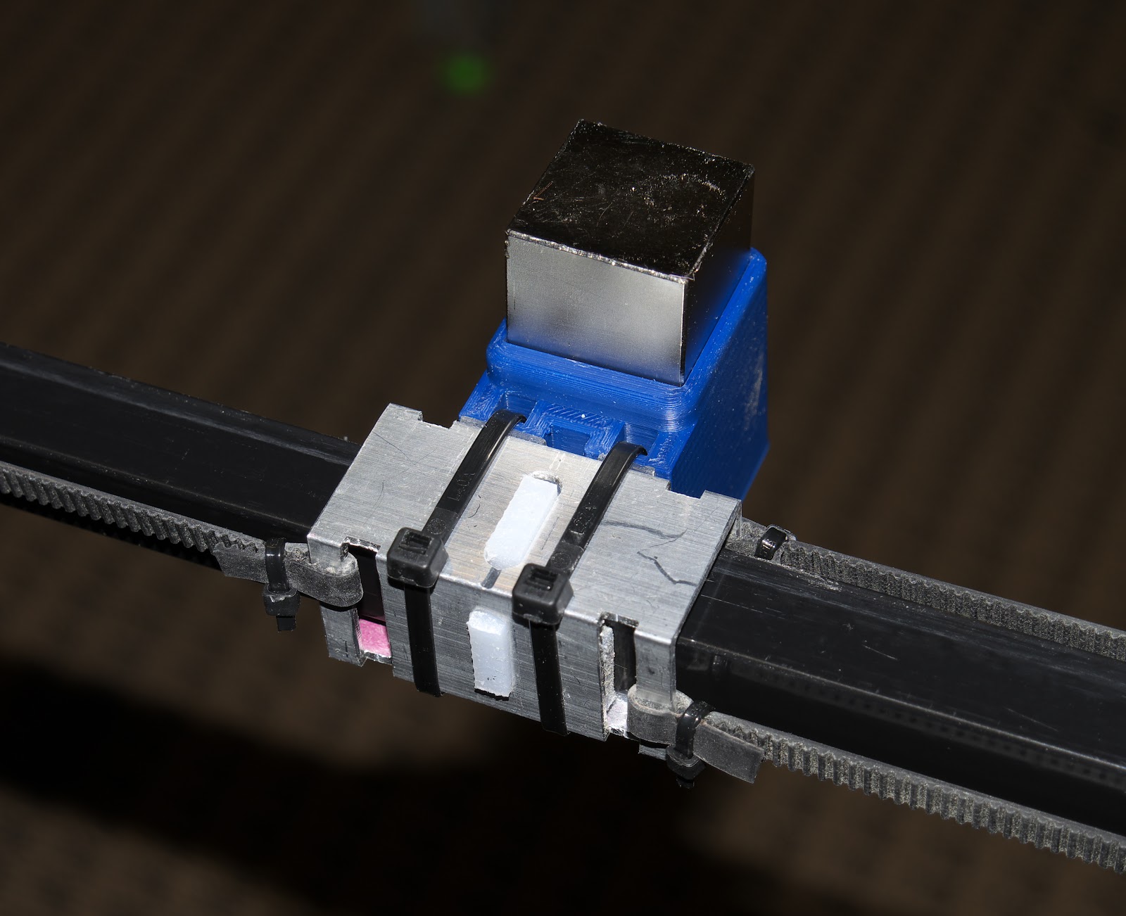

magnet carriage for the sand table
This is the magnet carriage. The 1" cube magnet sits in the suqare hole, on top of a spring that sits in the round hole. The spring keeps the magnet pushed against the bottom of the table top.

  • A new magnet carriage design
    Mark Rehorst11/04/2018 at 13:14 0 comments
    After the MakerFaire I opened up the table to check on the mechanism and found the magnet carriage badly worn.  The carriage was made of printed ABS and it was sliding on a powder coated aluminum X axis guide tube.  ABS/powder coating is not a good combo, and the ABS loses.
    Old magnet carriage design.
    Old magnet carriage worn bearing surface and cracked body.
    I have redesigned it to use a 1" square aluminum tube that fits over the 16 mm square X axis guide tube with room for UHMW bearings.  Milled slots in the carriage tube anchor the belts and hold the bearings in place.
    In this design, the aluminum takes all the belt tension force, so there's none applied to printed parts.  The magnet box is held on with zip ties and can be changed easily to experiment with different magnets.  It may need some indexing to prevent it from twisting.  The fit is a little tight right now, but I intend to sand blast the powder coating off the X axis guide tube and I think that will loosen it up a bit.  If I have to I can sand the bearings down a little to loosen the fit.
    More details here...
    New magnet carriage design for the sand table. from Mark Rehorst on Vimeo.
