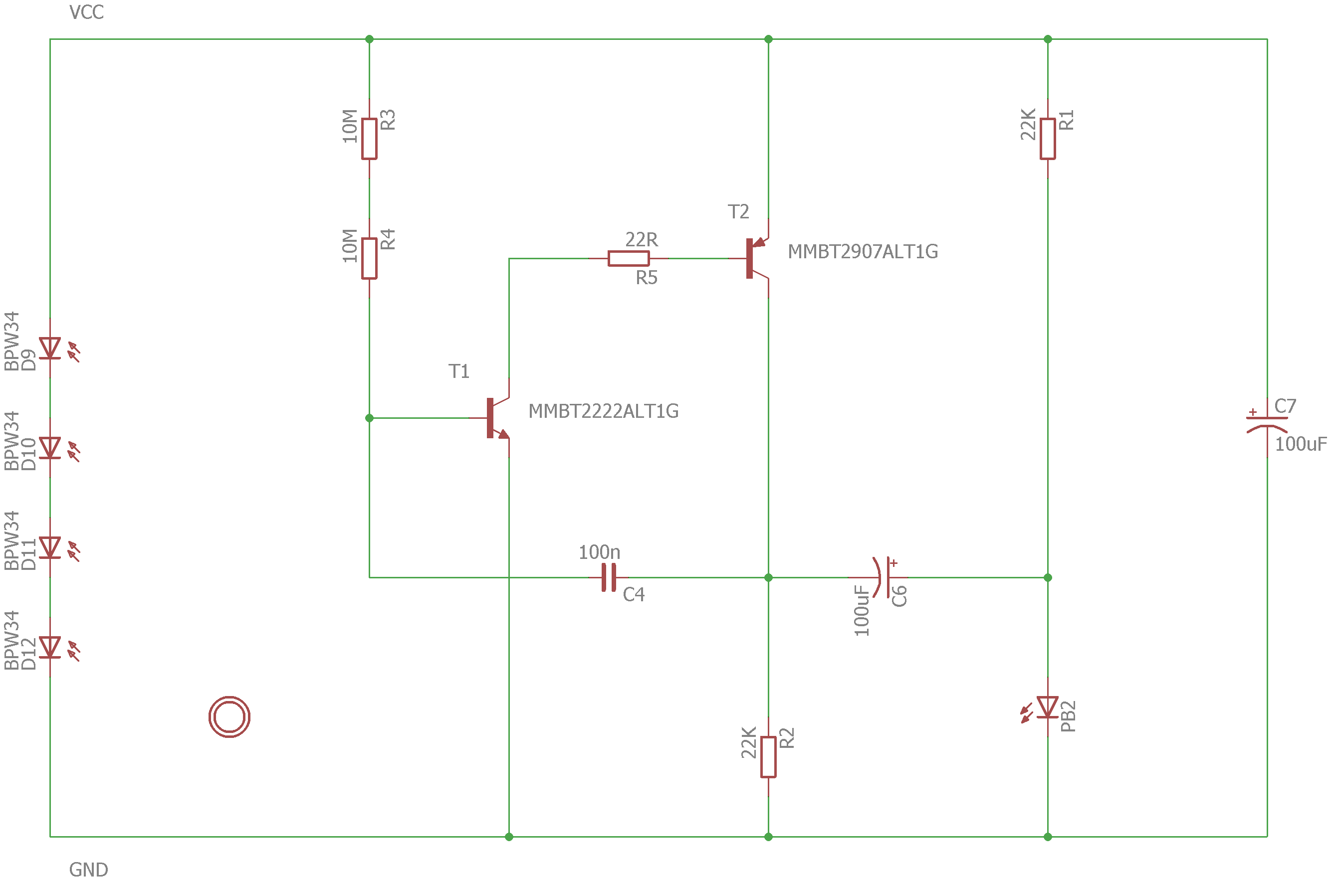

- indoor voltage from solar cells is only 1V and 1uA, it is harvesting masterpiece
Led flasher work as charge pump, multiply input voltage twice to get 2V pulses
Advantages compared to other designs.
  • discrete components, no special QFN chip (two standard transistors, 5 resistors and 3 capacitors)
  • based on charge pump design
  • work indoor, no direct sunlight required !!!!
  • startup current is less than 1uA, it is much lower than on commercial harvesting IC or designs

Kaspar Emanuel wrote 01/31/2019 at 15:09 point
These are really nice, is there a schematic so I can better understand the circuit?
phuzybuny wrote 11/28/2022 at 04:38 point
OP has a similar project https://hackaday.io/project/85457-ultra-low-power-energy-harvester-from-bpw34 with a schematic and image of a test schematic. However, the two schematics are slightly different (e.g., resistor values, placement, etc.).
