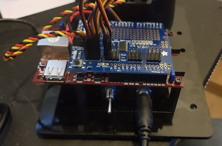

While we have the triple timer counters which are capable of providing the PWM signals necessary. We would also need to supply servo power at 6 volts in this application, therefore the simplest manner to make use of the Adafruit PWM Shield. This not only provides 6v power but also performs the level conversion on the PWM signal.
Ada Fruits Shield
Ada Fruits Shield
The next thing to work out is how to drive the signals, the PWM shield uses four 8-bit registers to drive each PWM signal.
The device on the shield the PCA9685 uses a 4096 bit counter. The on registers define the count at which the signal goes high and the off the count at which the signal goes low.
As such we can always set the on time to 0 and then define the count at which we turn the signal off, to give us the width of signal required.

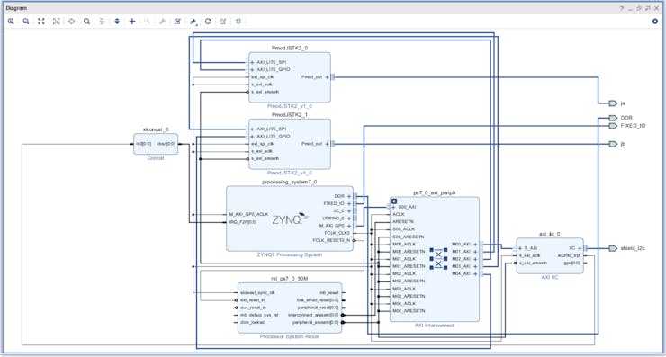

To be able to interface with the Pmod Joysticks and the PWM shield we need to first create a design in Vivado. This design will contain the following IP blocks
  • Zynq PS - This is the Zynq Processing System
  • Pmod Joystick 2 - Interface to the Pmod
  • AXI IIC - I2C interface implemented in the PL
Vivado Design
Vivado Design
To use the Pmod IP cores we need to have the Digilent Vivado library mapped in as a IP repository. If you do not have it you can obtain the repository here, you also need the Cora board definition installed, if you are missing these you can download them here.
Once we have the block diagram complete we can build the design and export it to software.

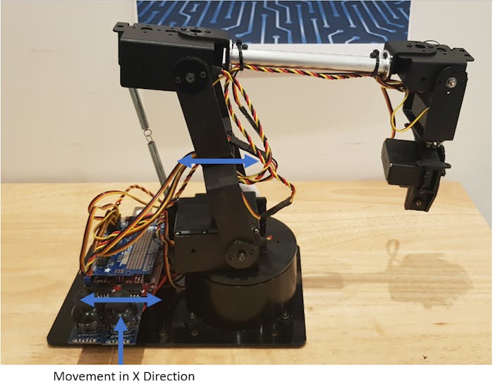

How we use the joysticks is interesting they give direct control over the arm. As such we need to ensure the movement between the joystick and arm aligns.
Of the two joysticks the first one is connected to JA and the second the JB.
JA when moved in the X direction will move the arm forwards or backwards, when moved in the Y direction it will move the arm up and down.
Moving JA in the X Direction moves the Arm forwards or backwards
Moving JA in the X Direction...
