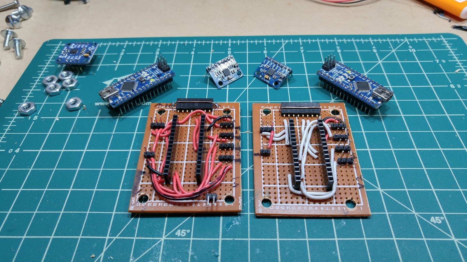

    The breadboard and connection board of the previous version were not only too hard to set up quickly but also very fragile and annoying to work with. I'd had enough so finally I went and built a nice shield that integrates almost everything while still keeping the Arduino removable so it can be used in other projects. V1 was a first attempt, all wires were red (bad idea) and shoddily laid out which caused a lot of headaches when it simply failed to work when powered up. Debugging when powered up showed the 5V rail hanging around 1.2V and not budging at all even when everything was disconnected. After a few hours of frustration my father walked by and offhandedly remarked to check the ground, much to my chagrin I found that I'd forgotten to connect the ground net to the ground rail which promptly fixed the problems (check for floating grounds). On the second revision the power and ground wires were in standard red and black while signals are in white (I ran out of wire colors okay?) in addition to being MUCH cleaner and better laid out. On the final...

    Back in the beginning of September I had started work on taking a prototype shield (these) and soldering the circuits on the back using standard hook up wire and converting it into a guidance shield for easier demonstration purposes and to minimize the rats nest of loose wires hanging out all over the place. This increased the durability of the entire system but hit a major hardware snag when it did not work as it did on the breadboard. The issue was it started moving the servos a single tiny skip then shutting the whole system down. What was happening is that the servos were drawing far too much current for the 5V pin and the Arduino shut down to protect itself as it thought it was short circuiting, not an I2C bus issue as I first surmised. I figured it out at last earlier this week, when I used an additional power supply for the servos (lots of power required to move 4 of them simultaneously). This fixed the biggest hardware problems I was having with a minimal amount of changes required to my circuitry (will need only an additional regulator) and no major changes to the code (will be moving the servo pins to PWM next revision). When you encounter an issue, first thing to check is for shorts, then to see if something else has gone wrong such as a misplaced connection or a solderblob jumped terminal that should not be connected.
