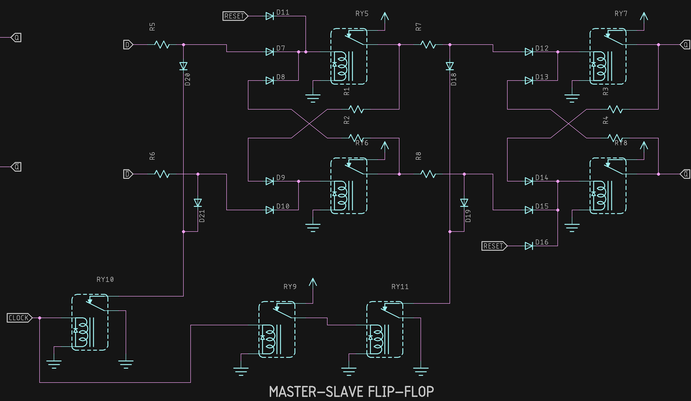

The next step is to make a clockable flip-flop.  I've chosen the classic two-stage topology:
I chose this topology because it can be done with only four relays. The diagram below shows seven relays, but three of them (at the bottom) are for the clock signal, and those get amortized over all the circuits in the same clock domain.  And, if you have an inverted version of the clock signal available (say from a previous counter stage), you only need two of those.  It's a normal two-stage flip-flop arrangement, with the inputs to each stage gated by opposite phases of the clock signal:
In the diagram, I've oriented the OR-diodes horizontally, and the AND-diodes vertically.  Since the AND gates need to pull down the high level inputs, resistors are used in the signal lines.  These resistors will have the same nominal resistance as the relay coils (499 Ohms) and the circuit will use a 10V supply instead of 5.  You usually see an inverter used to create Dbar from D at the input to make this a D flip-flop.  But, if you are just going to use them in Johnson (twisted-ring) counters, like I am, there's no need for this extra gate.  The Q and Qbar signals can feed the next stage's D and Dbar directly:
It's a modulo-10 counter perfect for the ones digit on hours, minutes, or seconds.  It needs 10 more NOR gates for decoding, but those could drive Nixies directly, or 7-segment displays through a diode ROM.

    I spent a little time today to get a full simulation of one digit going.  The box of relays arrived yesterday, but I had to be elsewhere today, so simulation will have to do for now.  The counter is made from D-flip flops like this one:
    As a two-stage flip-flop, it needs D and Dbar input, and also CLOCK and CLOCKbar as described in the project details.  The X{2,3,4,5} components are the relay models.  I made a mistake in a previous log that would prevent sequential logic from simulating correctly: the voltage controlled switch should have been across the resistor to simulate the proper delays.  Here's the corrected model:
    With this, the flip-flop works as intended.
