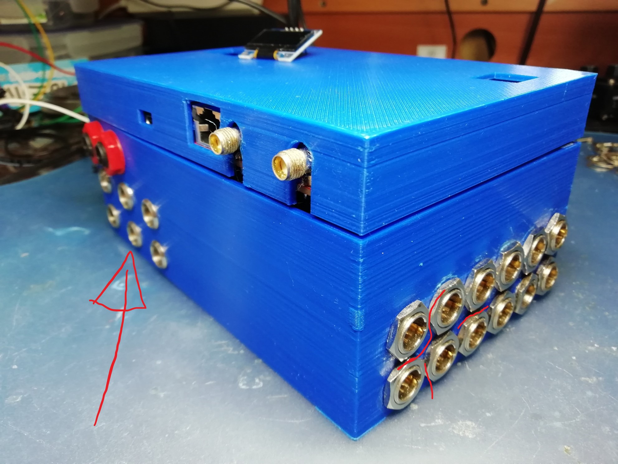

  • 3d printed enclosure
    ben biles02/25/2021 at 02:54 0 comments
    As you can see this is my 1st go with a 3d printer! It's actually my 2nd go at the lid. The 1st lid was completely wrong , always measure twice !
    my specially ordered miniXLR sockets with the nuts on the outside of the case are stupid. I realised the pcb on the back is worth 1$ so it's far better to put the mini xlr sockets in through the holes ( should be D shape 11mm ) then tighten the nuts / washers from the inside the case before soldering the pcb onto all the pins. need to add thread lock glue to those nuts I think or you would end up with a bunch of washers and nuts flapping about in between the sock and pcb eventually.
    cramped ugly nuts on the exterior of the case.. no ! got to go :)
    top right corner it a whole for the programmer cable.
    the uSD cards need more thumb room , it's a tweezer job to get them in and out !
    The whole case needs beveled edges , way too sharp everywhere!
    The bulge in the case is caused by the 40pin analogue board connector from ADC DAC card
    that protrudes over the edge of the board edges. easy mistake to forget that those IDC connectors are much wider than the box around the footprint on the PCB !
    for now I will just cut a whole in the case so it doesn't warp the box as I want to change the connector for light weight FPC ribbon cable , so its a problem that will eventually go away :)
    Well I guess this is the great thing about having a 3d printer , you just keep refining the case until your happy then get it made professionally. I didn't bother with vase mode or whatever is the best way to print. I used sun PLA+ which is slightly stronger than the usual PLA. But could well have used anything.

  • new board powered up and stm32H7 says hello :)
    ben biles06/25/2020 at 04:20 0 comments
    the new board powered up OK and the debugger talks to the new STM32H7.
    The H7 has more SAI ports
    I'm using the 3rd port for the TI audio code for LTC timecode IO
    The 4th port doesn't really configure in cubeMX as I've maxed out all the DMA channels !
    my main mistake so far i can see is I don't have the XMOS I2C as slave connected up to the an i2C master on the STM32H7 in the way i was going to. somehow slipped through the net!  the only use i could think for it was to shut down the XMOS chip for power saving anyway when not using AVB gigabit audio and/or aes3 and/or usbC pc mac connectivity. I find it hard to believe that little XMOS will cope with doing all three AES3 / USBC / AVB simultaneously but it's wired up like that in case :)
    I made a little 2.54mm 20pin -> 1.27mm 20pin connector convertor for the XMOS debugger to save board space.
    I'm still waiting for the TI codec IC / gigabit PY chip / RF connectors and USB C connector.
    I'm pretty excited to be able to use the interface with a DAW over AVB or USB C.
    In some ways it will be easier to test the analogue stuff without pulling the mico SD card out and inserting into the computer all the time !
    One thing I should have included maybe is another USB socket to mount the micro SD cards from PC/MAC but i don't think that will be to hard to add in future revisions.
    I need to also see if it's possible to add an SSD controller to an STM32H7. I imagine your moving towards having to run an operating system for that which i'm not really up for ! but if i can mount an SSD like the micoSD with a simple exFAT capable library in C then why not.
    OK, lots of firmware work ahead after I update the analogue board and click together with the board to board connector :)
    I will hopefully be able to reuse most of my code from stm32f7 but this time i'm using generated code from cubeMX and going to try adding my code in the user sections.. might be a trap ! herd horror stories of code being over written by cubeMX in user sections on forums so will have to make a lot of backups !
