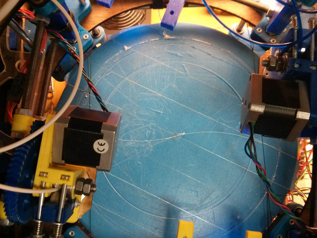

    Now that I know that the firmware works, its time to dial in the machine. As you can see in the test prints from the last log, the extruders are horribly out of alignment with each other.
    I wrote a G-Code script to generate a test pattern for calibration. It has each extruder draw a large circle and two arcs. The circle is for calibrating the position of the endstops and the arcs are for calibrating the position of each extruder along the arm. The distance from the pivot point to the nozzle needs to be exactly 160 mm. Ideally, the patterns from each extruder should be directly on top of each other and the arcs should intersect at exactly the center of the platter. Here is the code:

    And here is the resulting pattern:
    Its hard to tell from the picture, but the circles are way off and the arcs are lined up pretty well. I adjusted the position of the endstops in firmware by measuring the radius of each circle with calipers and comparing it with the expected value (96.226mm).

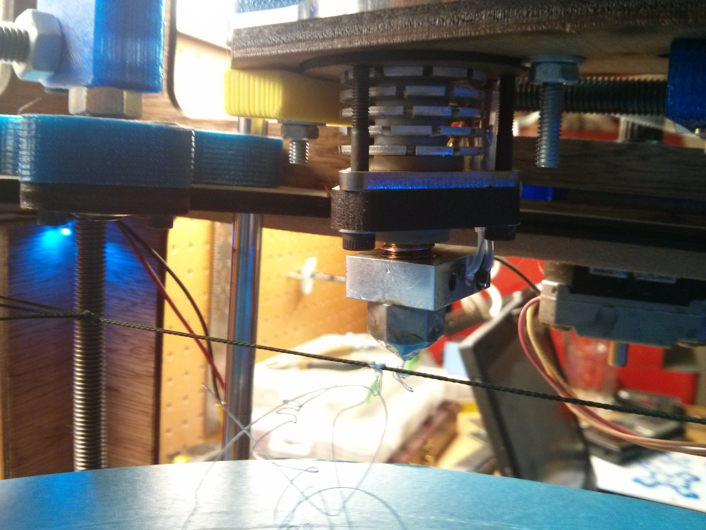

    Another problem is that the extruders ooze a lot when idle. The ooze gets carried over and stuck onto the print and it eventually builds up into big globs of plastic that the extruders crash into, causing them to skip steps. I tied some string so that the nozzles wipe across it when the arms retract, knocking off the excess plastic.
    I'm having a lot of trouble getting the nozzles level with each other and the build surface. Its like their vertical position keeps changing.

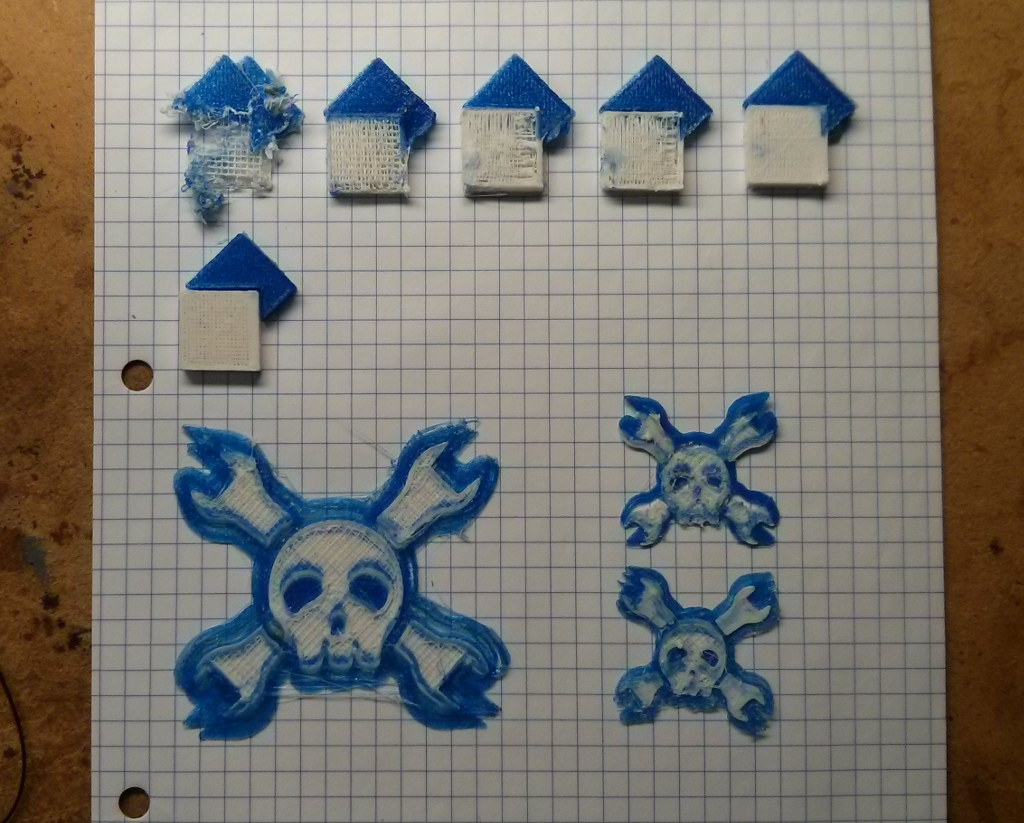

    Here's the latest test squares along with a couple failed tries at the Jolly Wrencher, which I put up on Thingiverse.

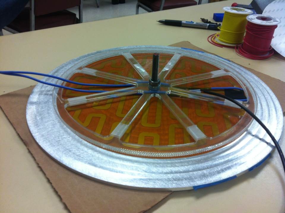

    Aluminium Platter
    The cross sectional view below shows the original design for the platter. It consists of two layers of circular plywood. The lower piece has a hole in the middle where a nut is glued in place to connect it to the shaft. The upper piece is connected to the lower piece by countersunk bolts around the perimeter.
    In testing, the wooden platter proved to be inadequate. The top of the platter is required to be extremely level. Its height could not vary by more than 0.25mm across the entire surface (the height of a single plastic layer on a printed object). Unfortunately, the plywood was naturally warped far beyond the tolerance. This test video demonstrates the problem (http://youtu.be/nC2cthvXTew).
    An attempt was made to level the wooden platter by soaking it in water and clamping it in place until dry. This was unsuccessful. We decided to construct a new platter out of machined aluminium, which would have no trouble meeting our flatness tolerance. It would also be better for the heated bed since aluminium is much more thermally conductive than wood.
    A suitable plate of 7075 aluminium was acquired from the scrap pile in the machine shop. This picture shows the plate being machined on a CNC mill to a diameter of 304.8 mm and a thickness of 4.2 mm. A hole was drilled and tapped in the center for the M8x1.25 shaft.

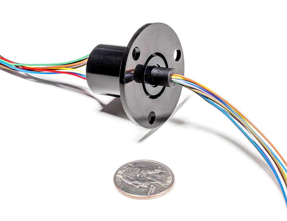

    Most 3D printers use an electric heating element and a temperature sensor under the build surface. Unfortunately, the spinning platter on this machine means the wires running to the heater would get wrapped around the shaft. The solution is simple. The electrical connections are passed through a slip ring to prevent the wires from twisting around the shaft. After extensive research, we found a circular 200W heater with a 240 mm diameter and a 12 connection slip ring.
    The slip ring replaced the central bearing underneath the platter. A hollow coupler was used to connect the shaft to the slip ring. Holes were drilled in the side of the coupler for the wires to pass through. Since each connection on the slip ring is only rated for 2 Amps, multiple wires were used in parallel to carry the full current of the heater. The heater itself is designed to operate at 24 Volts. Unfortunately our power supply only provides 12 Volts. Although the heater is run at half power, it still gets sufficiently warm given enough time.
