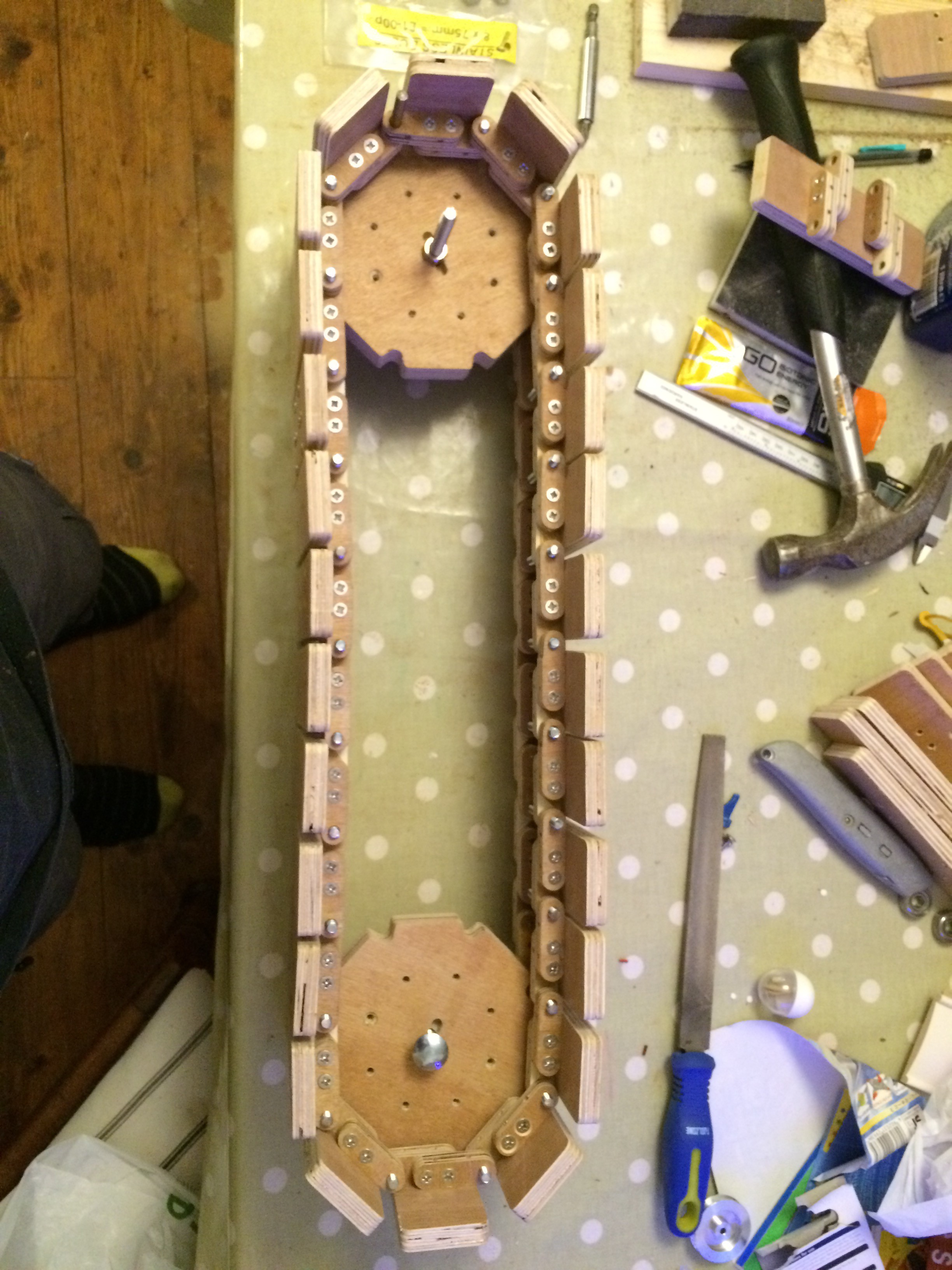

The most complicated part of the machine is the caterpillar tracks and It took me quite a while to figure out how this was going to work.  I was conscious that a small child's fingers could get stuck in the gears and the track links, however I wanted an authentic caterpillar track look, so compromises had to be made.
Caterpillar Tracks - Initially I wanted to use plywood for everything possible even the chain links for the caterpillar track.  Getting the gearing to mesh with tracks was interesting and I found gear generator program and played around until the correct number or track paddles and links where fully realised.  The images below show this development.
The drive gear and chain above had way to many links to be easily fabricated so I decided to reduce the number.
As can be seen the reduction in track links simplifies the entire design.
I then set about trying to make a very slender chain from plywood links.  The images below show the machining of the links.  I don't have a vacuum bed so each link had to be predrilled then screwed down before machining the profiles.
6mm holes for the pins, 3mm for the screws countersunk naturally!
Final profile cut.
Final links ready to be stuck together. Glued and screwed with stainless screws
Machining out the Track Paddles / Plates? Not sure what they are called?  Answers on a postcard please!
6mm coach bolts to pivot the links and engage with the drive wheel.  The heads where later cut off and replaced with nylock nuts.
The picture above shows the very first iteration which worked well for a bit but the links were very heavy with the many many screws helping to hold them together.  Also the quality of the ply used was not good.  This resulted in the links breaking under strain.  More on that later...
The picture below is of the drill jig for the chain links to mount the track paddles.  I soon discovered that all the screws where increasing the weight and each Paddle only really needed 2...
