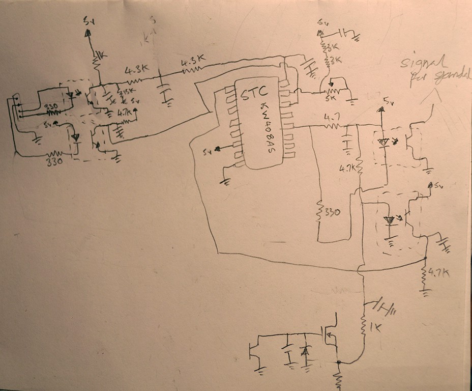

  • JP-1482 Spindle Controller Schematic
    Johnny07/27/2015 at 13:44 3 comments
    I've now reverse engineered the JP-1482 board and drawn a schematic of everything.
    The micro's connections:
    Control signals:
    Output to spindle and overcurrent detection:
    Power supplies and fan output:

    I've found the datasheet for the mysterious STC15W408AS microcontroller on the spindle controller board. Turns out it's a 8051 at heart. The datasheet is well documented and is surprisingly in well written english. The device is super easy to program too, only need a USB to UART adapter, Keil C51 compiler, uVision4, and a STC ISP application. Hopefully I can read the program memory and save it as a backup. This may be the neater solution. Just program the micro to have the PWM feature. I'll do more reverse engineering and have a play I think.

Love your work here! Thank you for posting your findings! I've been (somewhat) following your footsteps and also got the PWM spindle control working from UGS -> Arduino Due + g2Shield -> custom PCB -> JP-1482. But I also hit the problem with not reaching 100% speed. Mine maxes out at 60% even if I just feed 5V to the PWM pin. Did you ever find a solution to this?
Kari wrote 01/25/2024 at 21:56 point
Perhaps you've moved on from this old project? Anyway, I found your reverse engineered schematic which allowed me to do some experimenting last night. I measured the voltage at the STC micro ADC input at different PWM duty cycles from the low pass filter and like you, I found it only went down to about 2.5V @ 100%. Here's my measurements:
PWM 0% -> 4.78V
PWM 25% -> 3.325V
PWM 50% -> 2.929V
PWM 75% -> 2.647V
PWM 100% -> 2.516V
It felt like the STC is somehow preventing it to go lower. Not sure how/why... So I decided to cut the trace leading to the ADC input of the STC and measure the ("unloaded") voltages from the low pass filter again:
PWM 0% -> 4.74V
PWM 25% -> 1.358V
PWM 50% -> 0.720V
PWM 75% -> 0.365V
PWM 100% -> 0.220V
Big difference! But I can't explain what's happening here. Something to do with the ADC input impedance? Tempted to wire in a unity gain op amp between the low pass filter and the ADC input...
Kari wrote 01/26/2024 at 01:01 point
More experiments: Since I had the pcb trace going to the ADC input of the STC cut, I wired a 5K trimmer to it in order to see what voltages corresponds to what speeds. Here's my findings:
>=3.680V -> 0%
3.170V -> 25%
2.704V -> 50%
2.187V -> 75%
1.902V -> 90%
<=1.880V -> 100%
There seems to be very little or no 'adjustment room' between 90% and 100%. It's either 90% or 100%. That's how it feels when you're using the machine with the built-in pot as well. Now how to get this all working properly from PWM. I'm not sure yet...
Kari wrote 01/26/2024 at 23:02 point
Another semi-successful experiment today. I wired a single supply op-amp (RC4558) as a voltage follower buffer between the output of the low pass filter and the ADC input of the STC micro. This indeed allowed me to control the speed of the spindle 0-100% with PWM. However the speed maxed out already at around 18% duty cycle @ 1.28kHz so the control range is quite limited. I guess ideally all this should be tuned properly in the STC firmware but I have no means to do so. I 'll see if I can tune the op-amp circuit or the low pass filter itself somehow to produce better response... I think the challenge is that the response of the low pass filter is logarithmic and based on my experiments with the trimmer, the STC expects a linear(ish) input.
Johnny wrote 02/03/2024 at 03:03 point
Hey, thanks for sharing your efforts and nice work on the PWM experimentation. Sounds like you’re narrowing down the issues. Would be nice to see the original code in the STC and have people customising it. That was something I really wanted to try last time, I even purchased the chips to experiment with. From memory reading back flash contents wasn’t possible on these chips. It’s been a long while since I’ve played around with my 3040 though.
Enjoy ☺️
joekutz wrote 01/31/2024 at 21:16 point
Hi, looks like I am not the only one in 2024 experimenting with one of these machines! I liked reading about your experiments here, are there more info on your project? and I was wondering: Does your machine's PWM also sound that awful? Mine made a 490Hz whine noise, It drove me mad, and so I bypassed the control entirely (Video with details will be linked on my project page in two days).
greetings, joekutz
Kari wrote 01/31/2024 at 22:10 point
Hey there. Yes I'm still messing about with this. I actually did manage to tune up the op-amp circuit. It's not perfect but better. I posted more info in here in a form of a question:
https://electronics.stackexchange.com/questions/699252/how-to-linearize-logarithmic-dc-signal
Before I modified anything I had a look at the output voltage with my oscilloscope going to the spindle while controlling the speed with the built-in potentiometer. Mine was driving it at 1.28kHz so that's what I set as my input PWM frequency as well. It sounds just like it always has.
Anyway. I think my op-amp circuit hack is good enough for now and I'm going to leave it as is. At least until I get the rest of the machine up and running again and start actually using it. Most of the time the spindle is running at max speed anyway...

lksch wrote 09/09/2015 at 07:39 point
Hey Johnny,
great Job! i have nearly the same model, but i'm stucked to get Spindle on/off working.
I connected a arduino with grbl to the parralel port. I dont know what i have to do with the pwm connector on the JP-1482. Because of your shematic an pictures i tried to shortcut the
Sp on/of Sw+ and Sp on/off sw-. but nothing happend. Is the white ic on your cable to the this connector just an opto coupler?
On my board there is a  third yellow cable from the Poti to the Poti connector. Is that maybe the Problem.
When i want to tur the Spindle on, must the poti be at an "on" postion.
i hope i was able to describe the problem and you find the time to give me some tipps.
regards
Lars
Johnny wrote 09/09/2015 at 07:59 point
Hey Lars, thanks man :). Yeah what you saw was a opto-coupler. Those pins need to be shorted. To do this I used a opto-coupler as you saw. Those pins are actually the same as what's connected to the spindle on/off switch. So the dial still needs to be adjusted for the speed.
Hope that helps.
Johnny.
lksch wrote 09/09/2015 at 18:07 point
