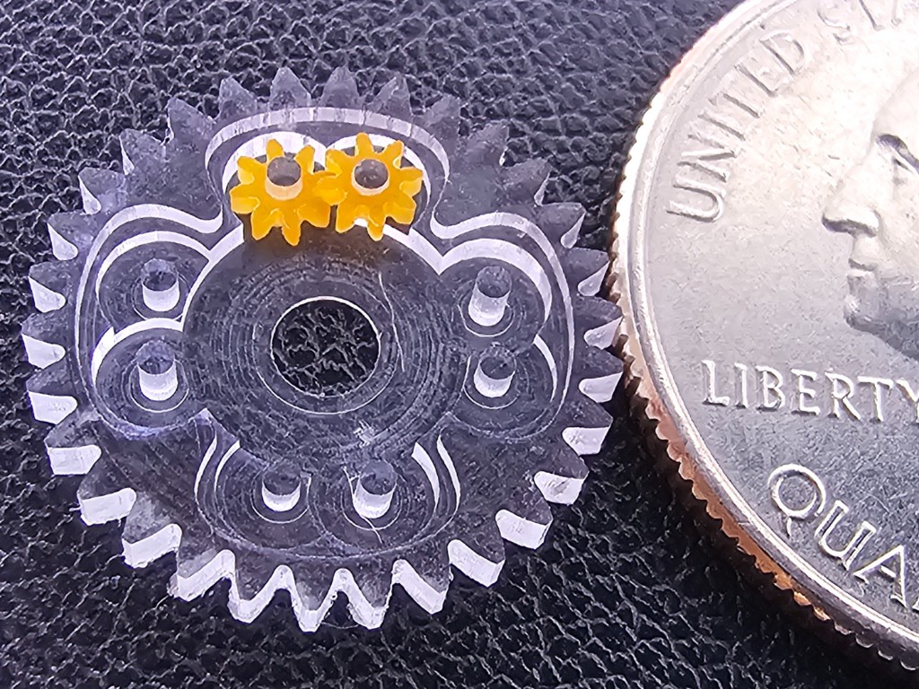

First I'll show this little bevel gear,...
... because the "3dp" 3d printed mill that is the object of this project actually for real cut that gear at MRRF. So I hope you'll accept some parts cut by the earlier laser-cut version of this CNC as an illustration of capability:

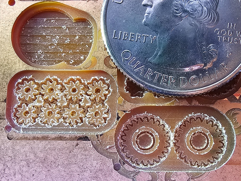

Spider gears and structure parts for a little differential with a US "quarter" coin for scale.
The spider gear assembly in the complete differential is smaller than my fingernail. There's a <4 min. video about that over in the "2dc" project but it's old work and too much about the earlier laser-cut design to include in this project.

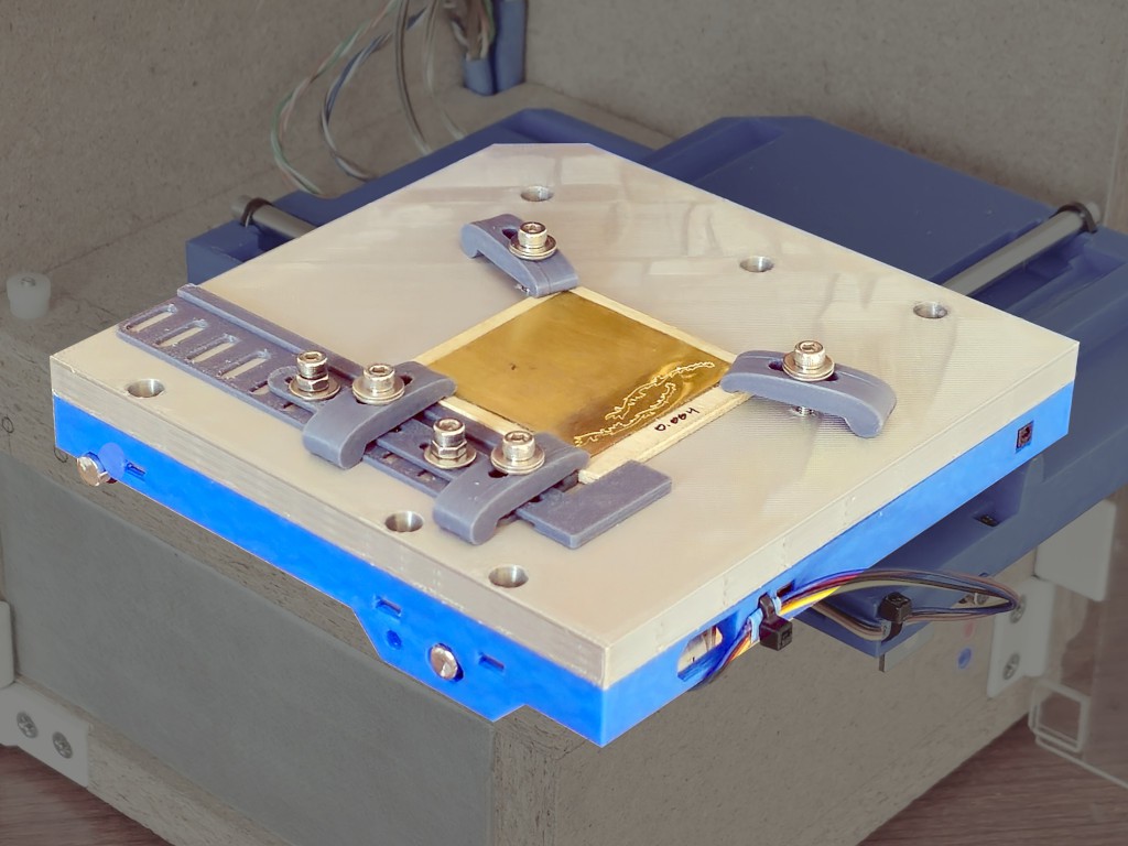

  • Workholding
    Paul McClay08/21/2025 at 17:29 0 comments

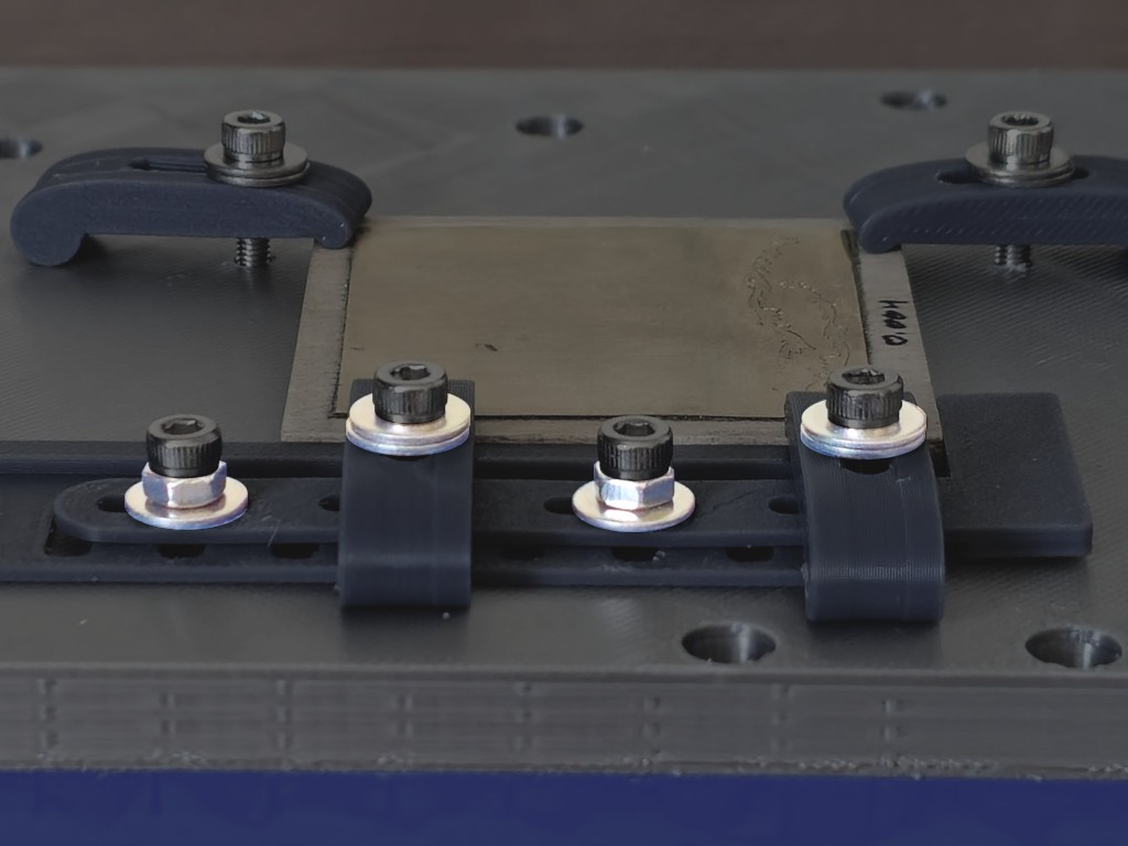

    CNC milling/routing involves holding the thing that's getting cut.
    (If you aim to build one of these for yourself, start here not here! This is extra complexity you almost certainly do not need! More exclamation marks: !!)
    I've been using double-sided tape to hold work since the second iteration of the laser-cut precursor to this project. It's hard to beat for simplicity, and it works well enough often enough to make some stuff. But sometimes it reminds me to think about mechanical workholding again. After a few years of no good ideas, I think this might work.

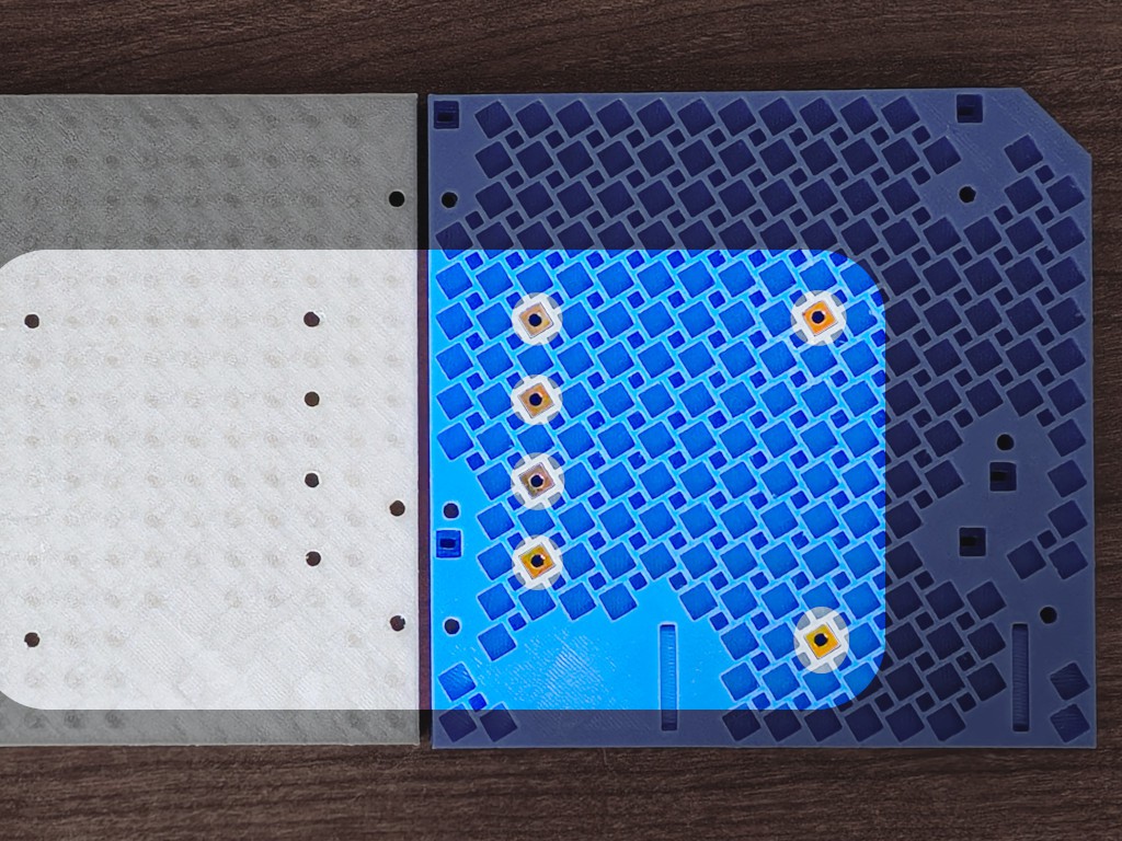

    spaces for nuts below and places to drill for screws above -- with an arbitrary 10 x 10 patch of nuts just to show what 100/207 looks like
    That's

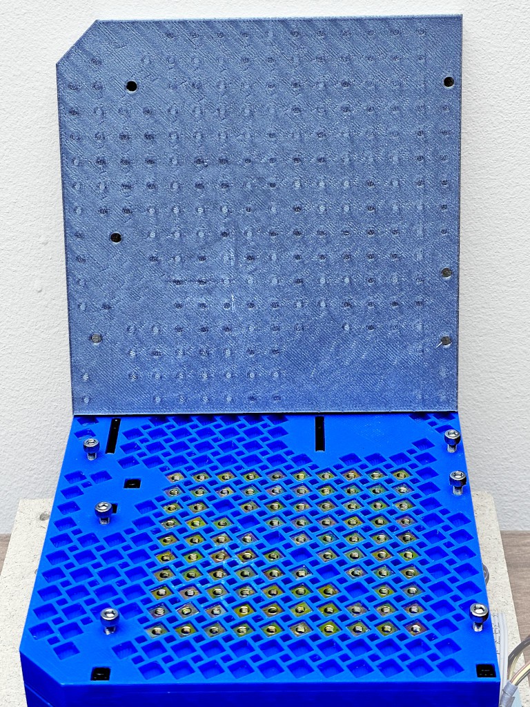

    • a bunch of square nut pockets sunk into the formerly flat top of the "top" part, and
    • a new flat slab on top of that.
    Slab
    I don't know what to call the new slab on top of the top part (of "bottom", "middle", and "top" parts of the XY stack). If it were square-rigged, it would be the t'gallant part. Maybe it will be just "slab" for now.
    Outwardly, the slab is just a flat slab with ½-dozen screws through it. Between the solid top & bottom surfaces there are void holes aligned with the nut pockets in the top surface of the top part. More to the point, "holes" means vertical cylinder walls around the holes to bear compression.
    Because ... why?

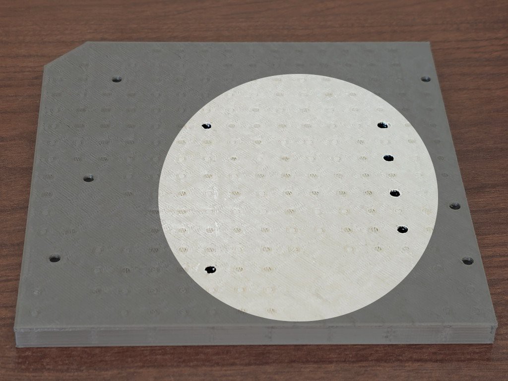

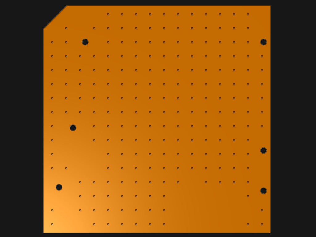

    Wherever you want to screw/clamp/hold work on top of the slab, drill through the nearest "drill here" mark on the bottom of the slab to open the top and bottom (i.e. bottom and top) of one of the internal voids and drop a nut in the corresponding pocket.
    The selectively populated 8 mm square grid of "drill here" marks is easier to see in the CAD render below than in the photo above. (even tho the marks are bigger in the photo)
    "legal" points of 8 mm × 8 mm grid
    I don't know whether or not this idea is actually novel, but I don't recall seeing it anywhere else. I also don't know whether or not it is actually useful, because I haven't actually used it to make anything other than pretty pictures for this page.

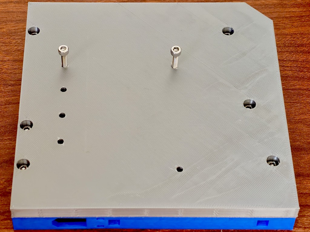

    Here is a (i.e. the) a worked example:
    drill through "legal" grid points nearest where you want to place screws
    drop square nuts into corresponding square nut pockets
    secure the slab on top of the top; now there are robust metal threads under the drilled holes

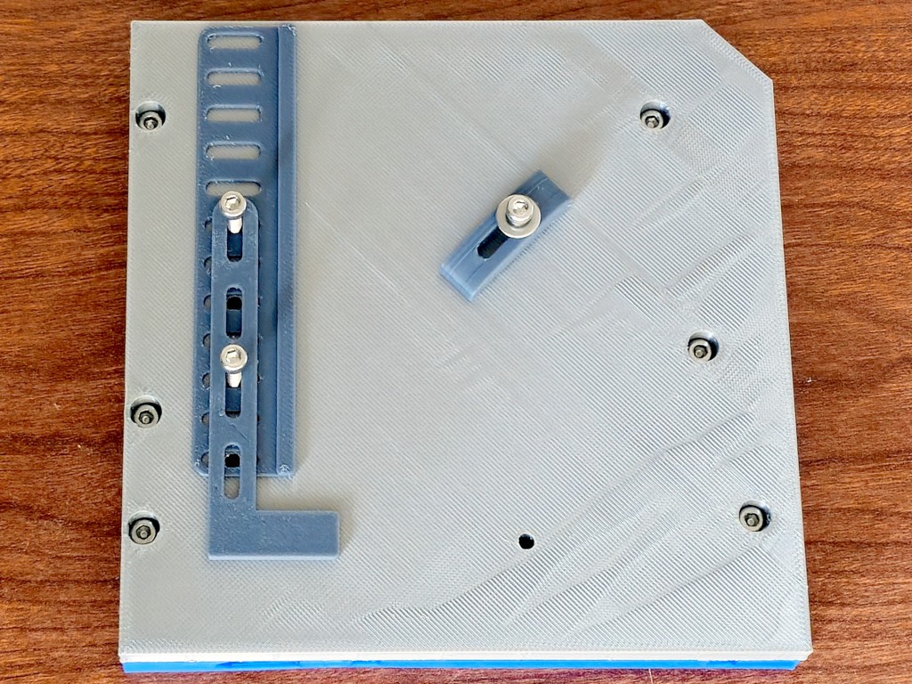

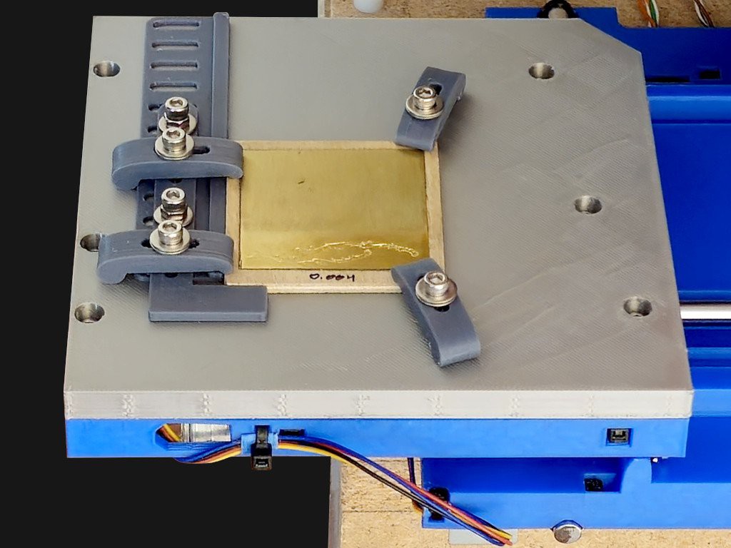

    workholding widgets
    workholding widgets holding work -- in a repeatable(ish) position
    !!: different length screws shimmed to near-exact lengths to fully engage nut thread without bottoming in shallow pockets!
    Maybe
    Of course it works. Because what could go wrong? ¯\_ (ツ)_/¯
    vibration
    Screws working loose from vibration is the first risk that comes to mind. The bet here is that clamped PLA is springy enough to prevent that. If not: Thin square nylock nuts would be great but I haven't found such a thing yet. Common hex nylocks would require deeper pockets (thicker top or fewer pockets) and holding a hex nut shape against torque with PLA is less easy than holding square nuts. McMaster-Carr lists "thin profile" hex nylocks, which seem quite pointless in smaller sizes: 3.9 mm thick vs 4 mm for m3. It appears that barleycorn nuts run thinner per thread diameter: 4-40 thread at 2.85 mm diameter is 95% of m3 diameter (90% section area) and "thin profile" 4-40 nylock nuts are only 2.8 mm thick or 70% of m3 (4 mm), so "thin" 4-40 nylock nuts could be accommodated within current dimensions with some very thin pocket floors. There are also anti-vibration screws: e.g. with a patch of nylon on the thread, or "tri-lobe" shape (tho use with steel nuts would be off-label). Or maybe just 3 mm o-rings under the screw heads.
    widgetry
    Those totally credible-looking "workholding widgets" were totally just whipped up to make the few  ̶p̶r̶e̶t̶t̶y̶  helpfully illustrative pictures above....

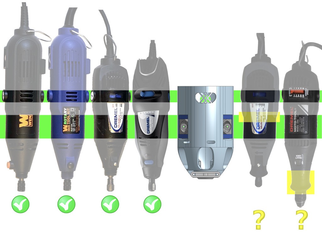

    Choose a rotary tool
    In keeping with the low cost/less stuff theme of this project, the Z axis is designed to hold a vanilla Dremel®-like rotary tool for a milling spindle. Clamping and releasing the tool is meant to be easy, so you can use the daily-driver you may already have and drop it into your little mill when you want to do a little milling.
    What will work?
    The tool clamp is designed around a tool body pattern set by Dremel (i.e. Emmerson) in a prior millenium. I don’t know of any simple name for the type except that they look like this:
    current Dremel product image
    Many Dremel tools that look like that are called “MultiPro”, but the form was up to “type 5” before they were called “MultiPro” and not all “MultiPro” tools look like that. Current Dremel products have mostly moved on to different shapes, but Dremel still (mid-2025) sells their low-end 100 & 200 models in this style, but you probably don’t want one of those because they lack speed control, but several generic labels are selling 5-speed clones that look like they come out of the same molds as used by whoever makes Dremel’s 100 and 200 units these days. The basic pattern includes a straight cylindrical body segment between a taper down to a threaded nose below and a fatter section above that includes brush bosses and a vent or switch at a fairly uniform height.

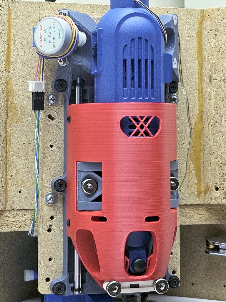

    The tool-carrying sled
    • clamps around the cylindrical part,
    • clamps a ring screwed on the tool’s nose, and
    • allows clearance for the extra stuff above including access to the switch or vent at the level of the brushes.
    Like this:
    For tools with the switch between the brushes, clip out the lattice for access.
    For a Dremel 300, clip out the thin bits around the spindle lock boss.
    The left four models fit as intended. I’ve used the first three and @janvorli on the Discord server has verified that his Dremel 300 (the fourth) fits. For tools with the switch between the brushes, clip out the lattice for access. For a Dremel 300, clip out the thin bits around the spindle lock boss.
    I haven't tried the questionable two on the right, but only looked at photos and marked features that differ from what the clamp was designed to hold.
    The long nose of the “type 3”...

    In the previous entry about contacting local scale model builders to ask if they might appreciate an accessible little CNC machine, I mentioned a couple tries at making a "trail board" for a Midwest Model Shipwrights member.
    People have been making scaled-down models of inconveniently large things for a long time ... and I've abandoned hope of summarizing that in a sentence. Making detailed wooden models of wooden ships stands a little aside from the model-making mainstream as we approach the 21st mid-century AD, but the venerable practice persists and practitioners gather nearby.
    Wood has grain. Scaling down wooden parts has the effect of scaling up the wood's grain. Very fine grain woods mitigate that with good success well established[1]. But trying to capture finer detail at smaller scale eventually turns into trying to carve a tea set from a stack of sewer pipe.
    From last time:
    • I wrote about FR2 exceeding expectations as a machinable material not entirely completely unrelated to wood but with essentially no grain. "FR2" is an imprecise term for the brown resin-saturated paper board used for the cheapest, simplest circuit boards.[2] Similar material is available by other names. Contrast with FR4 which is glass fiber+epoxy and hostile stuff to work with. I'm thinking this paper+phenolic stuff looks promising for compatibility with wood model construction, but that remains untested by actual model builders -- that I know of. But maybe I'm just the last guy to get the clue. Some "phenolic paper" material is advertised for "enhanced" or "finest" machinability. "FR" = flame retardant.
    • I had started off in the wrong direction with the first couple of whacks at the "trail board" example. Further information clarifies that what look like scrollwork borders of a flat board appear straight only in profile. The ornamented part is parallel with the mid-plane so it can be taken directly from the drawing. And the builder already has the structure and only needs the decoration.
    So, back to the drawing board.
    Then milled a patch of FR2 down to 0.3 mm thick (or so I thought, but it came out more like 0.34mm -- dunno why) and from that cut out a mirrored pair of figures using a 20°, 0.1mm Vbit. I didn't feel like testing how deep it could cut without breaking the tip or deflecting when I really wanted the best narrow cut and sharp inside corners, so I ran six passes at very conservative ~0.05mm steps down ("~" because a little more to match four Z motor half-steps). I expected that to cut through or very nearly so. But it didn't. So I ran a few more half-steps down until the bottom of the cut looked different. I was complicating this for myself by trying to cut no deeper than necessary because deeper makes the V cut wider.
    When I peeled that up it turned out of that I still hadn't cut through. My current guess is that maybe the glossy surface layer has a different consistency so the top of the bottom skin looks different, but I don't know. In any case, that was initially disappointing. Then I tried sanding the remaining thickness off the uncut side, and that worked quite well.

    The first example I tackled was this "trail board" -- one of the pair of decorated boards that sometimes dress up the pointy (or blunt*) end of a ship.
    The trail board, which I understood to be flat, looks like it runs from the stem back to a point where the hull has some breadth. I guessed that it might be oriented something like the blue and gold trail board on this model:
    source: Roland's Ship Building Blog (that part is pewter, and so maybe a candidate for milling instead)
    Supposing so, then the profile drawing shows a projection of the board leaving two degrees of rotation to determine the correct shape. In between me asking for, and the builder of that model sending another view, he described the boards in a vertical plane. So that's down to one rotation. A first proof of concept demonstrator doesn't have to be actually correct, so I guessed and projected from the drawing to make a solid model. The yellow inch ties model scale to the drawing.
    (wrong first guess -- later this will get corrected)
    While the ornamental figure has a convoluted outline, it appears essentially flat in the drawing. Maybe the prototype was more viney/leafy and maybe a larger scale drawing would show that. For a first whack, it's convenient to believe that it really is supposed to be flat and extrude the traced figure into a "2.5"D solid.
    First articles: port & starboard figures cut from 0.001" brass glued to a chip of hardboard.
    Sharp inside corners were the main challenge. These parts were received as good enough to validate the idea; next try could be sharper. In part because the underlying surface could be more nearly level -- note left end of the upper part vs right end of the lower part.

    The first Z axis was ... good enough to not fuss with for a while while fussing with the X+Y axes. The second try (i.e. first attempt to improve) was meh. This one came out better.
    The moving part & clamp changed more than the fixed part. I'll have to decide whether to make the next one slimmer or make the base plate behind it wider.
    The most visible intent/reality gap with the first 3d printed (vs. 2d laser-cut) Z axis was the fiddly half-dozen M3 socket head screws in the tool clamp.
    The clamp screws ran into single-perimeter holes. That "worked" because pull-out strength can be ok. But it didn't really work for the idea in mind because the hole threads were vulnerable to torque-out and wear from frequently turning the loaded screw  ̶k̶n̶i̶v̶e̶s̶ threads (call it "slice-out"?). That required attention and a tool to torque up the screws carefully, and to carefully torque all of them instead of just half (one side) to ensure even (i.e. minimum) tension.
    Not the quick, casual, routine operation I had in mind.
    Reducing that mess to two thumb nuts:
    • better reflects the "very inexpensive" idea of making it easy to drop in a daily-driver rotary tool
    • improves durability by turning metal nuts on metal screws to secure/release the clamp while the screws in plastic can be driven once and left alone.
    A less evident fault with the first printed Z axis was sagging PLA around the warm motor.
    left=up; right=down
    The motor mount screw holes yielded some but didn't fully fail. I don't know if that's because it stopped creeping after I turned down the motor current, if it relaxed to some equilibrium and stopped there, or if it was ten minutes from falling apart.
    In any case, it wasn't a big surprise that the PLA softened.
    For the first version I opted to just print it and see what happened before getting too wrapped up in trying to anticipate heat effects. It didn't take long to confirm that the pulley(s) couldn't be PLA. PETG is working fine there (white vs. blue in the second pic). The motor attachment to the base part wasn't so obviously bad. It looked fine for a while. Distortion around the screws became evident after a while but wasn't a big deal. The screws continued to hold. It was "ok" to use but definitely needed some help.
    I suppose it's possible that with two motors the motor current could be reduced enough to keep the motors cool enough for PLA. I haven't tested that. (A second motor/pulley/cord can be installed for cheap insurance against dropping the big angry part. That's more of a concern in the laser-cut version where the cord/s is/are hidden and run close by sharp edges.)
    In the second version I tried embedding hex nuts at the surface -- middle in the pic below. They didn't help pull-out strength which still relied on the screws holding in the plastic part and I doubt they got any less hot than before. The idea was to try spreading the radial load over a larger area of PLA. I think they actually helped more than what I had in mind: by fixing the screws perpendicular to the motor tabs they spread the radial loads much more by requiring the motor to drag the whole screws sideways through the PLA if it was going to go anywhere. They also protected the threads in the PLA hole from stripping by providing a hard stop to torque the screws into. It looks like they worked because there's no indication that they moved. Caveat I didn't run that version very long or in hot weather.
    While the nuts seem to have worked well as far as tested, that arrangement had a couple of drawbacks. If a nut were removed, I didn't have any great ideas for how to put it back in the right orientation to match the nut thread to the hole thread. And nuts would add a line to the BoM which I'm trying to keep short.
    For this version I'm trying PETG plugs in the PLA part to hold the hot motor mount screws -- right side in the pic above. PETG (or whatever...
